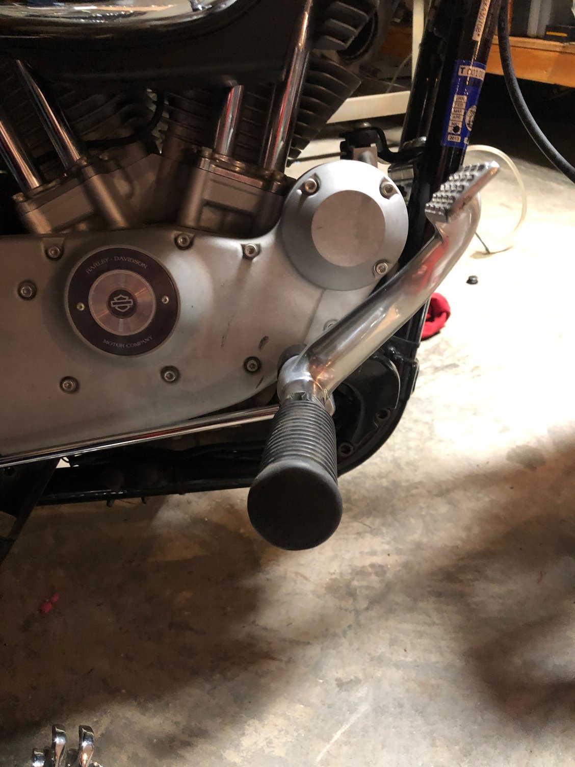

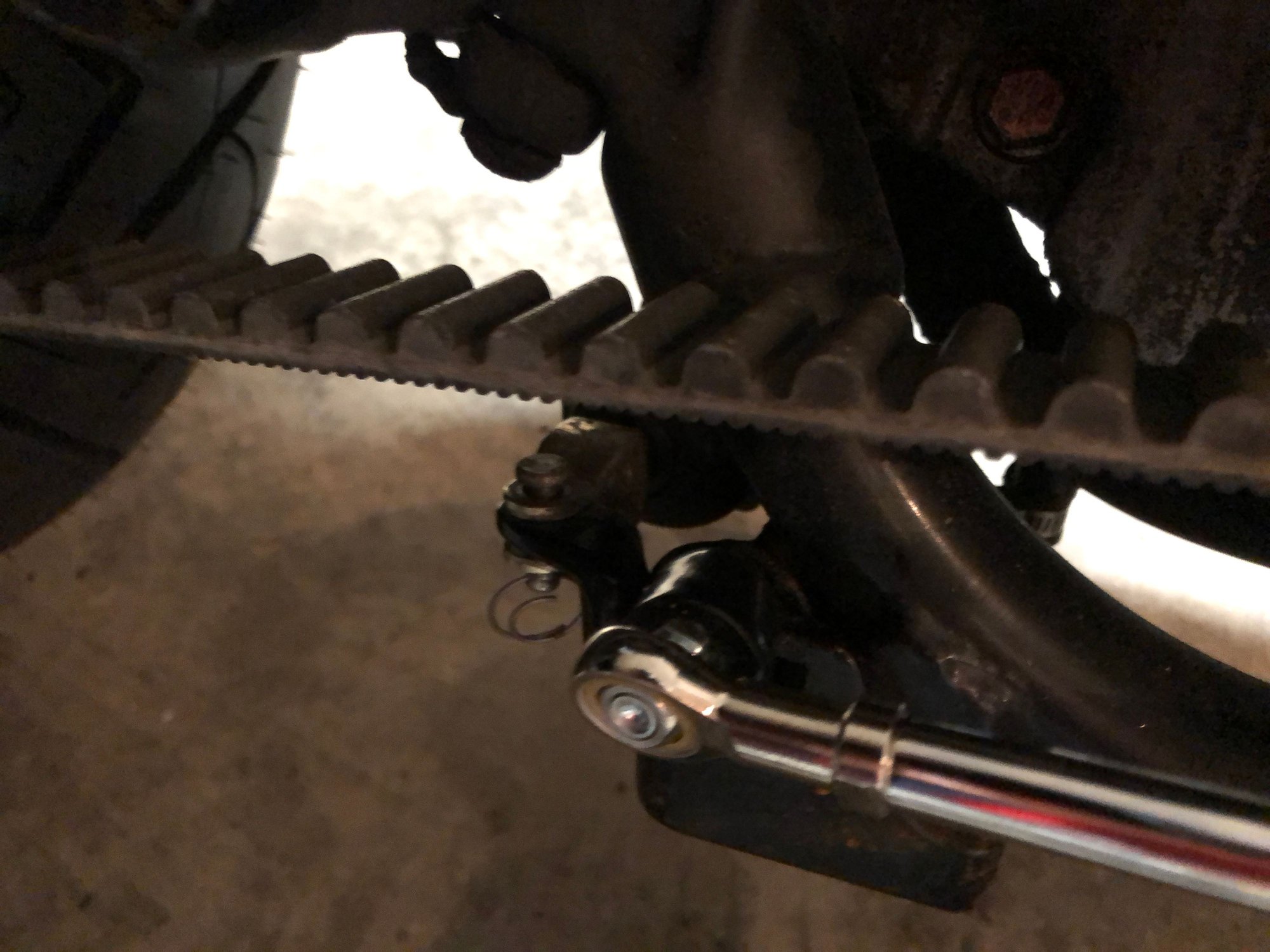

I bought a sportster 883C that was previously dropped. When it was dropped the foot brake pedal took most of the impact causing the linkage to break off. The bolt on the linkage/tie rod broke off inside the foot pedal. So I ordered new linkage rod and pedal.I got the linkage rod and pedal installed today. And now with everything installed the foot pedal is sticking up at like a 65 degree angle vs the normal of like 35 degrees.
There was a lot of air in the lines so bled those but didn’t seem to help much. While waiting for those parts in the mail I changed the tires and also changed out the brake pads. I’m thinking maybe that affected the brakes somehow with the brake rod not being attached to the brake pedal and compressing the pistons pulled something out of whack?
The linkage that came in the mail is the exact length as the old broken linkage. Posting here in hopes someone has experienced this. Any help would be appreciated
Pedal attachment
65degree angle
Rear attachment

You can adjust the brake pedal height with the adjusters on the end of the linkage.

The OEM HD rods are a fixed length so who knows what you have there but the angle of the lever doesn't look that different to the Custom I have here.

yeah pretty close to yours. If mine was like that I wouldn’t be worrying about it but it’s just high eneough that it’s an unnatural movement and uncomfortable. I ended up ordering an adjustable rod that I can shorten to help the problem

DK started offering an adjustable rod fairly recently

yep. Exactly who I ordered from. Sounds like it will do the trick
