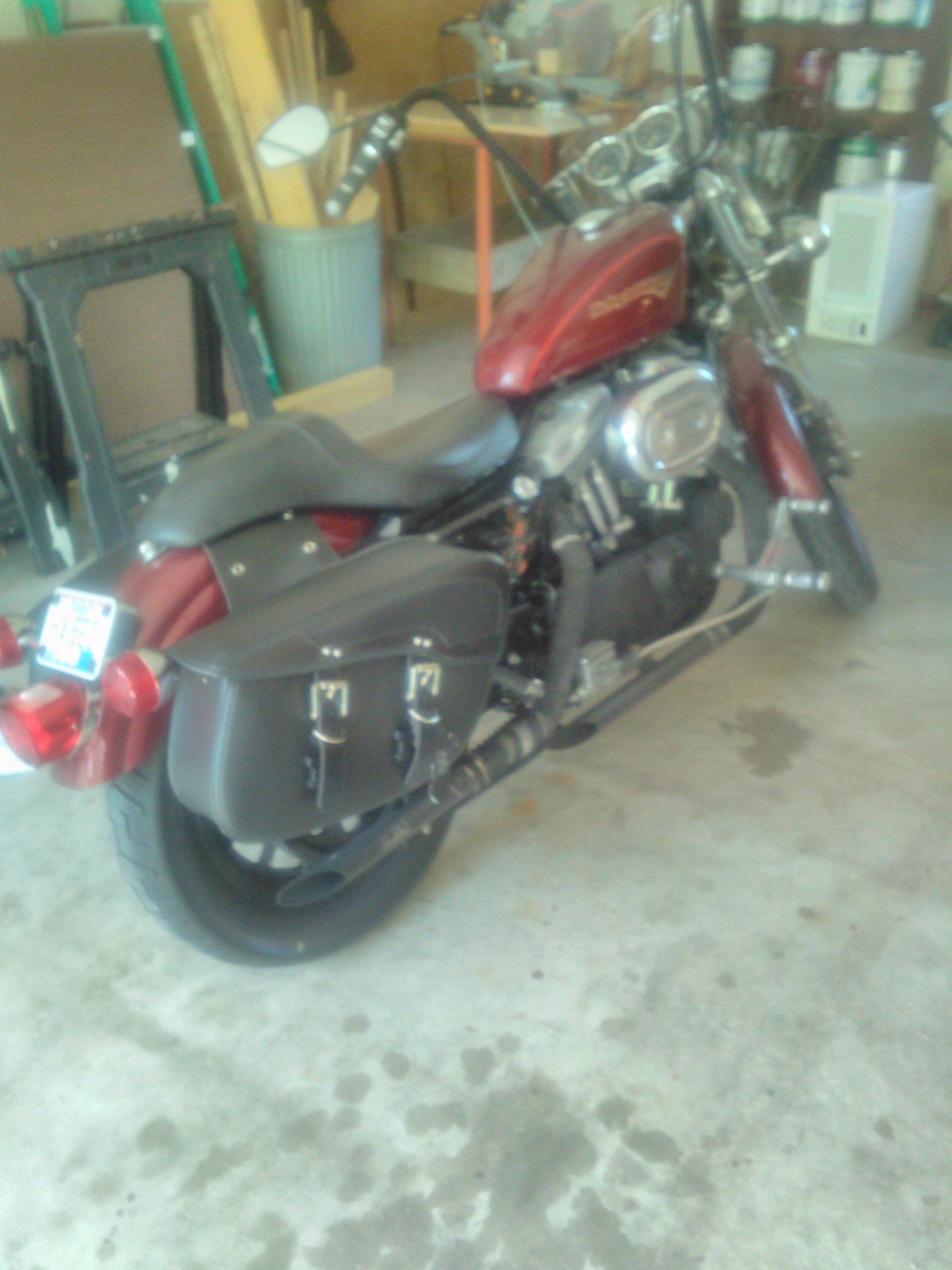

I recently got back on 2. I have a 2000 Sportster Sport with a 4 plug Blockhead engine. I had it rebuilt and rewired by Denny's Harley Davidson in Springfield Mo. ( great job guys ! ) while I was in the process of relocating from Illinois.
I have been told a lot of things like there is no engine called a Blockhead it's an Evo. The 4 plug engine was put in a lot of Sportsters during the 90's - 2000 to it was only put out in a few Sportsters from 99-2000. Oh and the best one...there was never was a Sportster called a Sport.
Can anyone fill me in on ..is this 4 plug called a Blockhead ? How long was it produced ? How many Sportsters was it put in ? Is my bike called a Sport ? Thanks

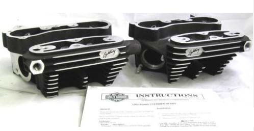

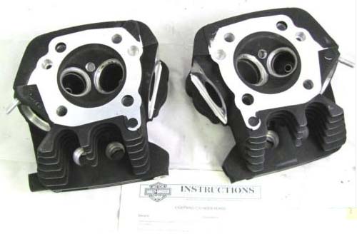

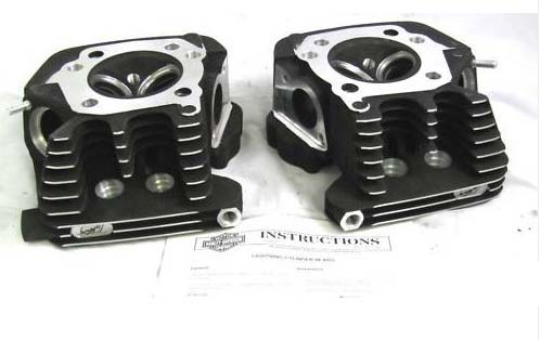

Single plug Lightning heads were also offered as an accessory (this pre-dates the Screamin Beagle stuff):
Notice the "Lightning" script above the pushrod area.
Later, when Screamin Eagle was launched, these heads were offered with "Screamin Eagle" emblazoned on them and they were drilled and tapped for the second plug, although they provided you with a bolt to plug the second hole if you didn't want it. That head was identical to the 1200S head except for the SE script on it.
The Lightning head was really the first generation Evo Sportster factory performance head. The valves and ports were actually identical to the stock XL1200 hemi head of the day. The only difference was more material added to the chambers, to drop the volume from 67cc down to 62cc, thus bumping the compression up from 9:1 to 10:1 when used with flat top pistons.
