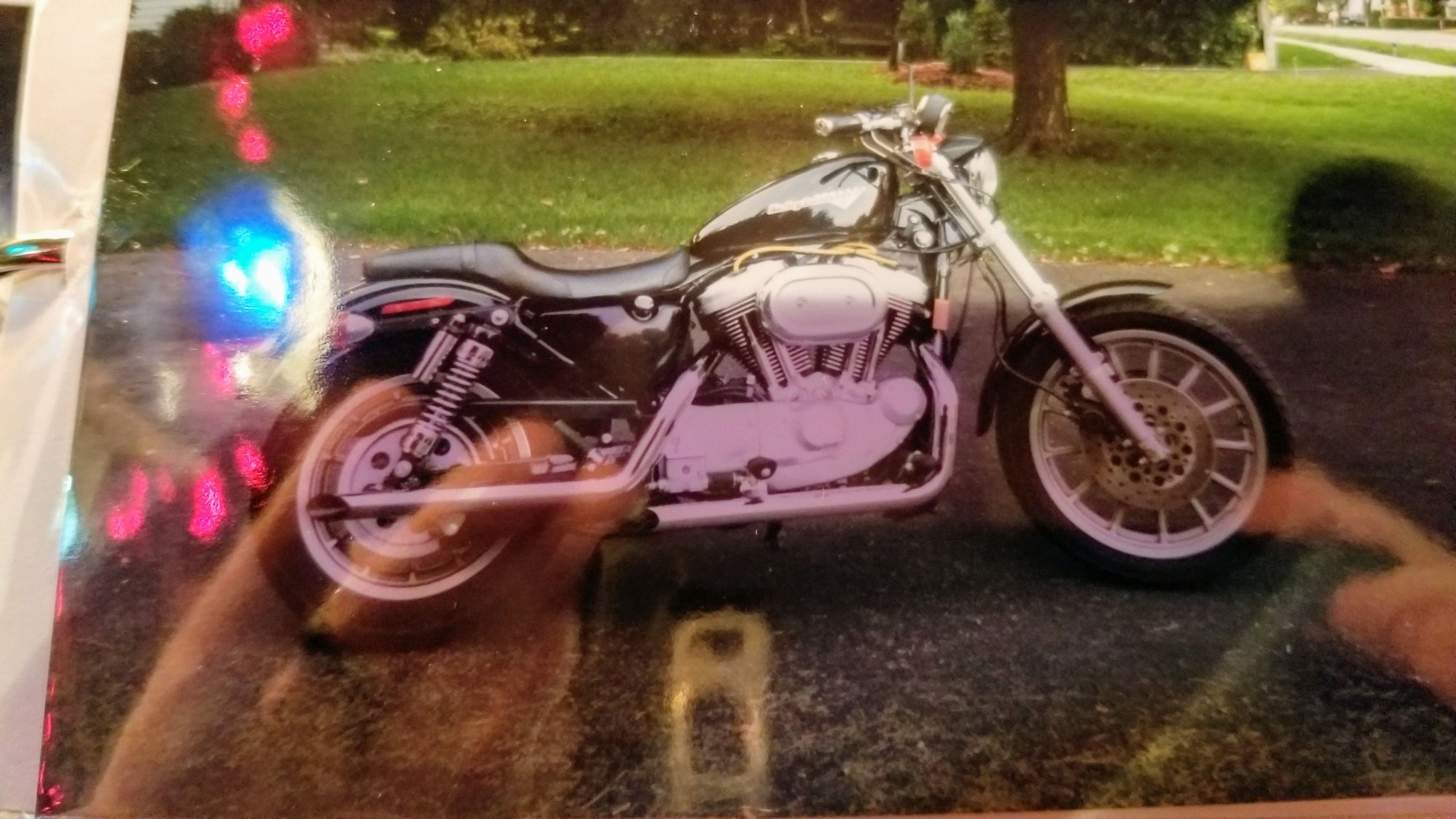

I miss my 1998 XL1200S
Sporty's are fun 💪
