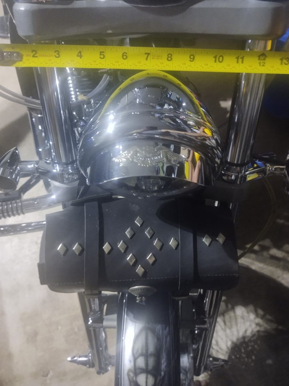

Default Fork Pic's
Originally Posted by QC
Any pics so that we can verify what you're talking about?
Don't know if these will help? Tried to hold tape measure for some aspect. Not great pic's thou....

Interesting last picture. It appears your are showing 12" centers. But it also appears the start is not at zero.
Is that parallax and tape is at zero on other side?

Wide Glide conversion would be 9.875" center to center, so looks like a wide glide conversion.

Looks like a Wide Glide front end with a Sporty fender. Wide Glide fender would have the fender support legs splayed outwards. I see spacers to fit the narrow Sporty fender.

Will be putting a tape to them and get an exact measurements for the width.
