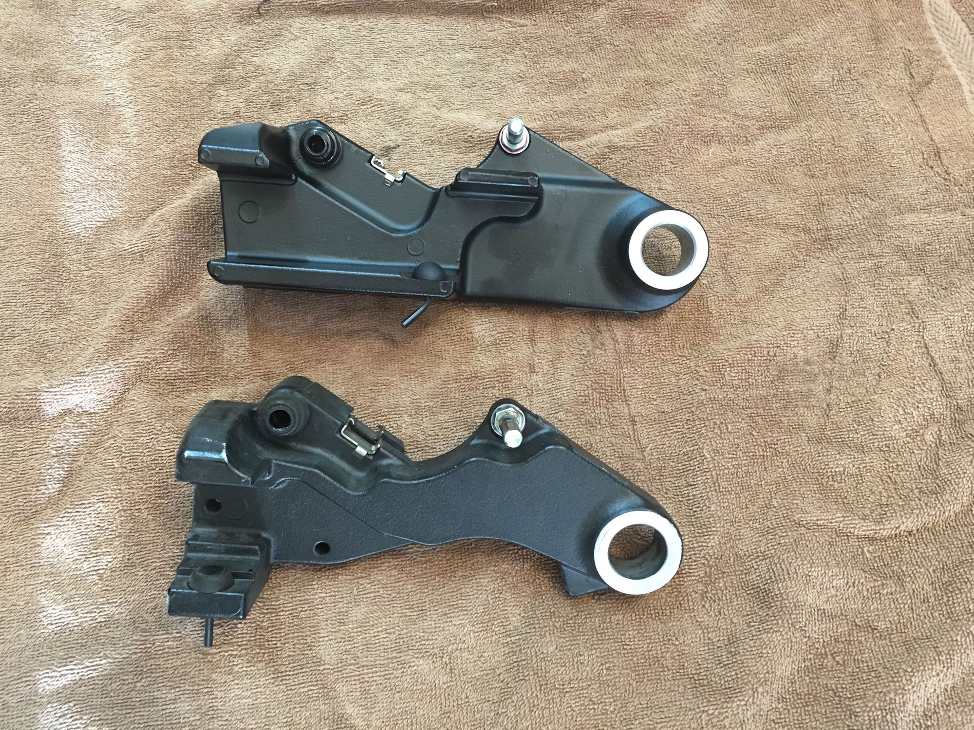

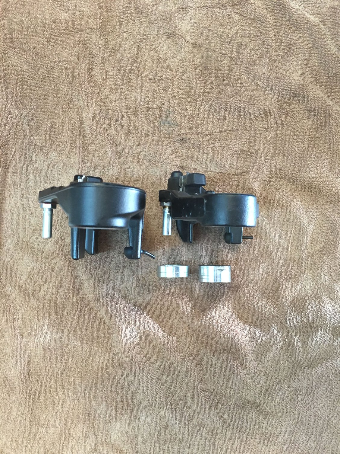

Well, it's not that special, just need the bracket from the older models.
Granted I'm not sure the 'newer' caliper will fit the older style bracket.

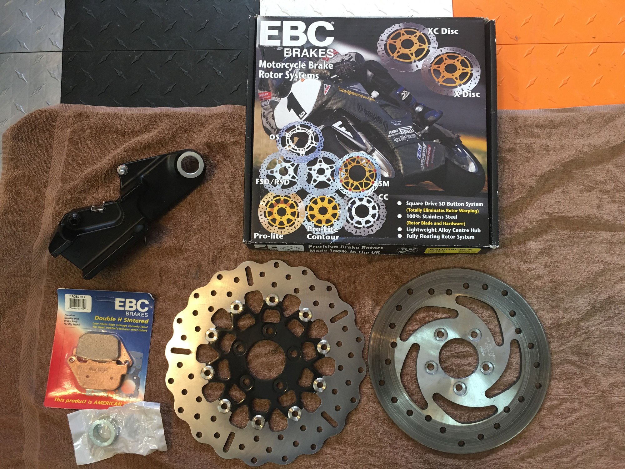

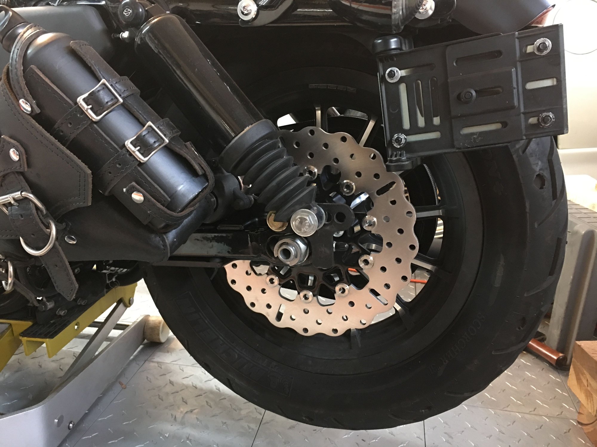

I went to a larger EBC floating rear rotor on my '13 Iron. A few pics:
good luck,
T.
