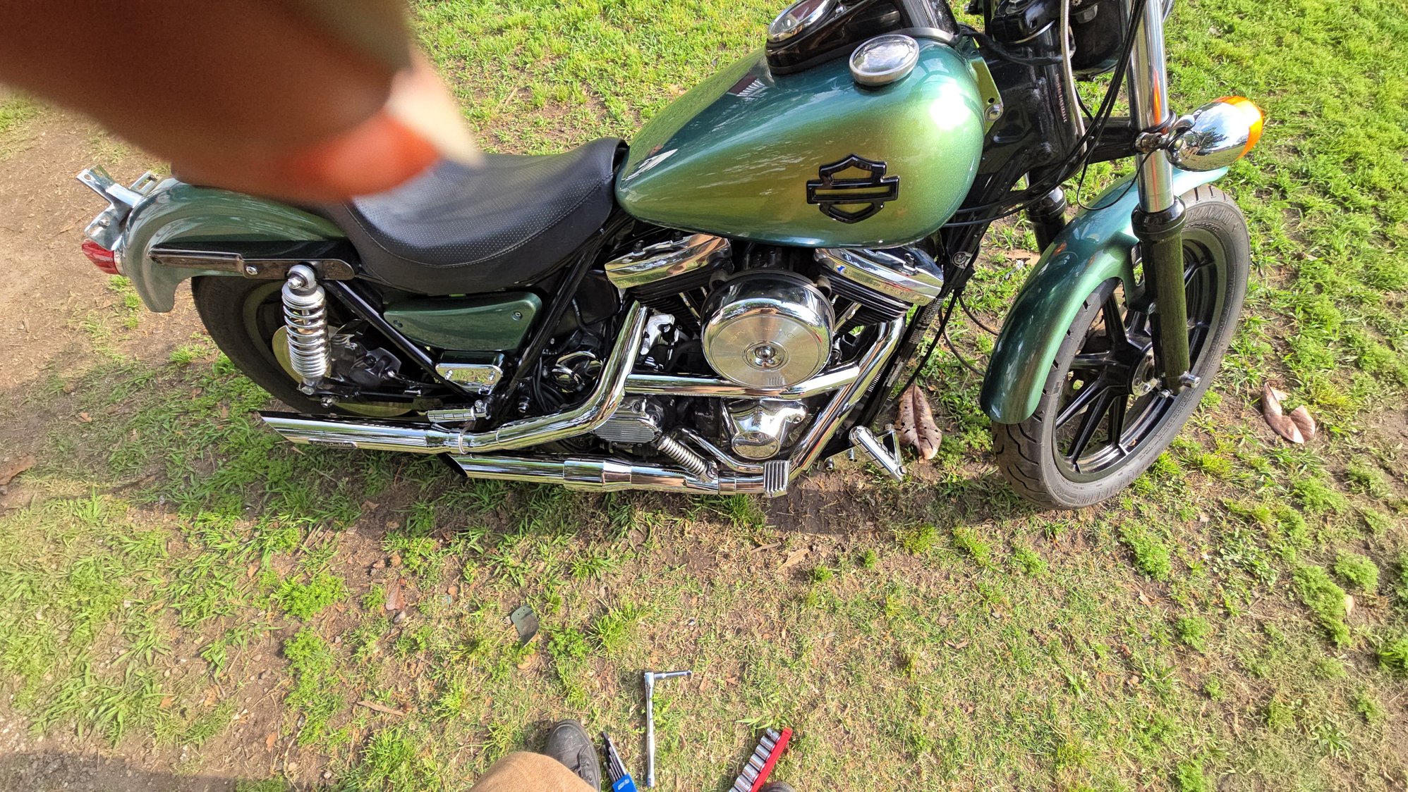

Discovered there is a Crane Cam h1-4 installed. So anyway finally got it started however while it's running there's a backfire or cough like sound from the carburetor every few minutes but continues to running. What causes this?

Cough at carb frequently indicates lean mxture
Air leaks at intake ?
Carb jets too small
( P.S. you`re posting in the Sportster section)

Think I spelled it correctly. However it mounts to the head ports with rubber like boots from manifold attached to the carburetor. Is this normal?

Yes, rubber compliance fittings were used early on
They crack and leak

What are they described as I'll replace them if I know what to call them when ordered?

"COMPLIANCE FITTING"
F is #27008-83A
R is #27012-83A
NLA from HD
But D.Kirk has aftermarket version
