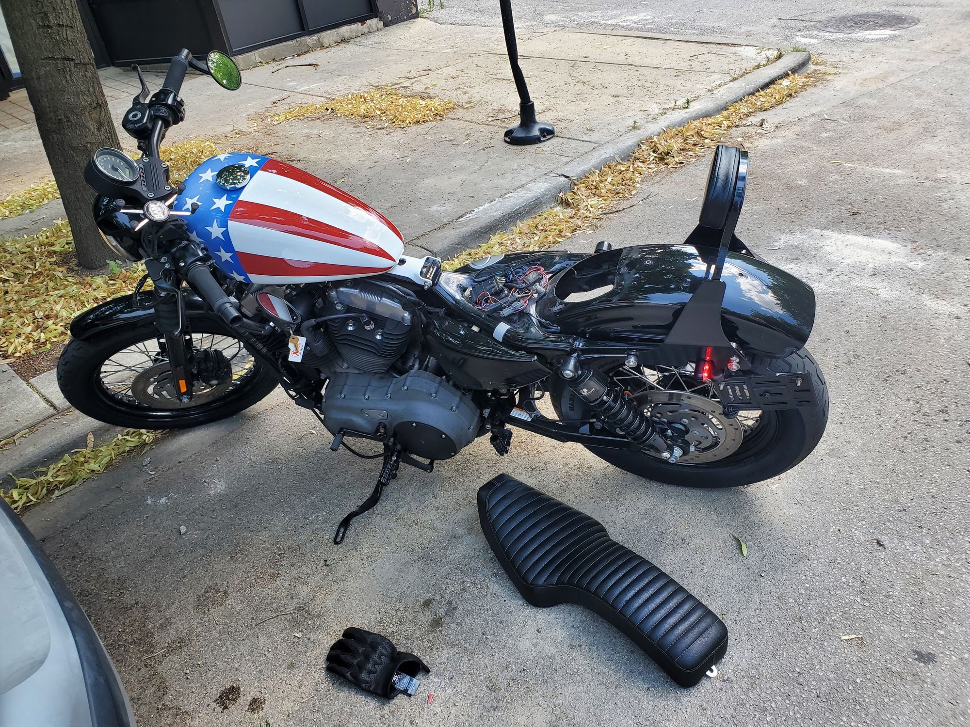

Last week my seat bolt shook out on a 2 hr ride and my seat fell off. Two weeks before i did a 4 hr ride and the ignition almost fell off. I simply tightened bolts to fix it, but ive been surprised that things literally shake off this bike. This leads me to believe i better be prepared for some loose nuts and bolts if i go offroad or dirt roads.

It leaves me to believe you should do a proper service on the bike before you go. Using the FSM it shows which fasteners should have loctite and how tight they should be. If loctite is called for the torque figure takes that into account.
Check every fastener now. The FSM talks about increasing the amount of servicing for abnormal riding conditions.
