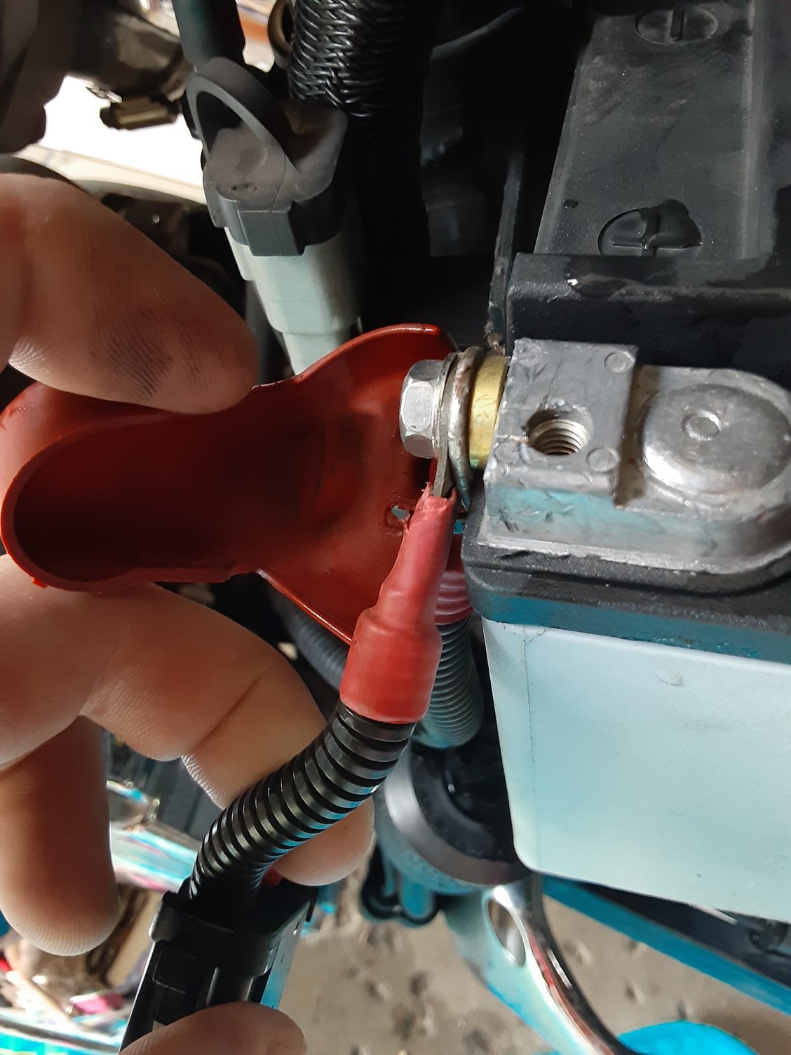

It is a tight fit, sliding the battery in can loosen the cable. I suspect a bad ground connection.
I found this when I was having a similar problem, you have to peel back the insulation a bit to actually check. The ground where it connects to the engine sees a lot of vibration and will eventually break. I suggest when you replace the cable you get one a few inches longer to make it easier to pull the battery in the future.

Would improper ground make the bike lose power like that?
No negative wire from the battery and you lose all power. From the picture above that is possibly from trying to pull the battery out with the wire still connected to the engine.

My picture above where the cable is breaking from the connector is the engine end from vibration, I would check that. You said it regained power when you pushed towards the oil tank, you could have a loose ground connection at the battery also, or when you pushed it in you manged to get the connection at one end or the other to make a butt connection that won't last. Factory cables don't give any slack and the constant movement of the engine will eventually break the wires. You lose ground you have no battery circuit, dc makes a circle. Till the cable breaks completely it may work intermittently when the cable is moved and sometimes making enough contact to complete the circuit. When starting the bike there may not but sufficient wire to deliver the current required and you get clicking.
