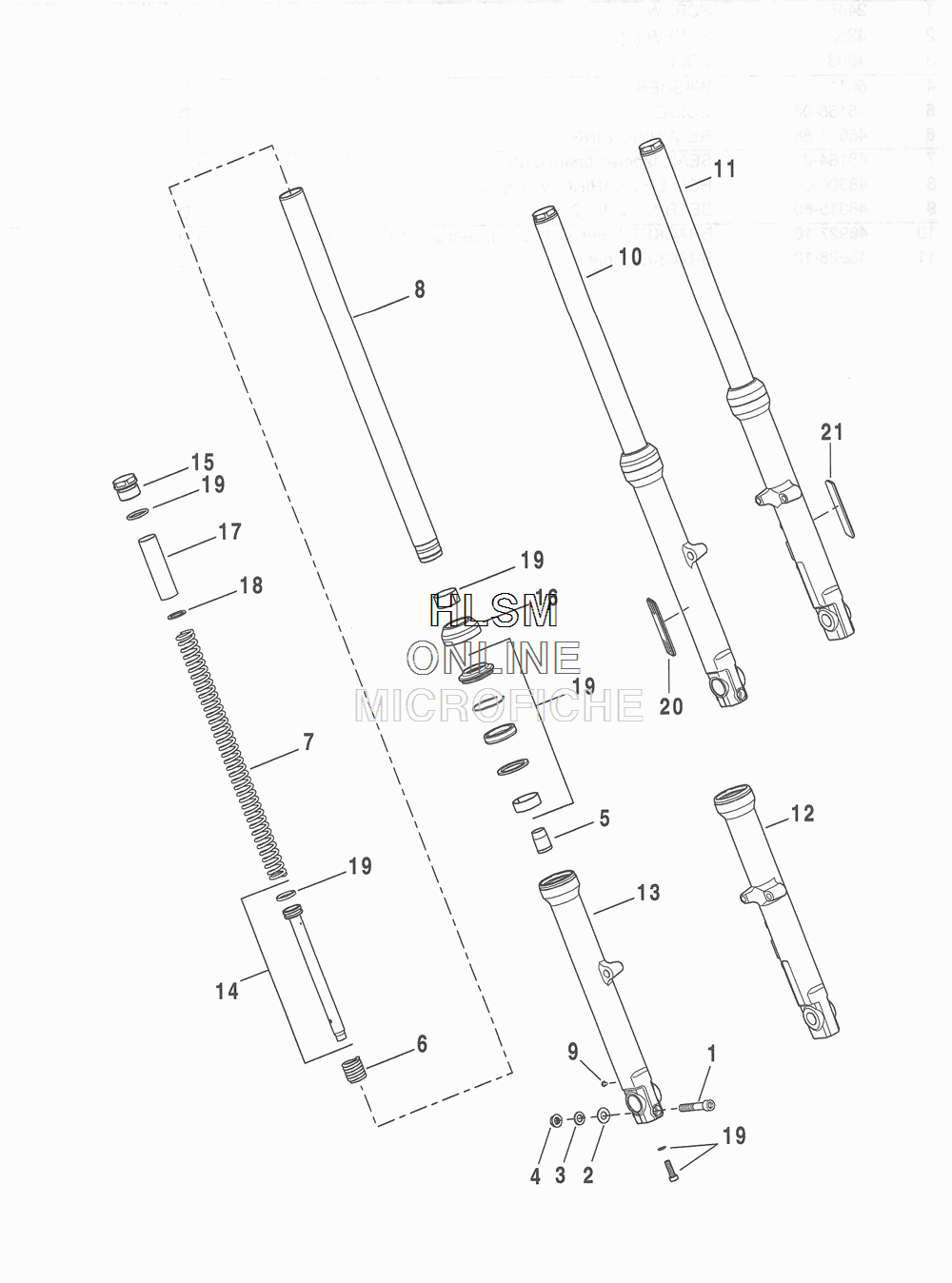

Here's a 'basic' image showing the parts - from RonniesHD Microfiche...
T.

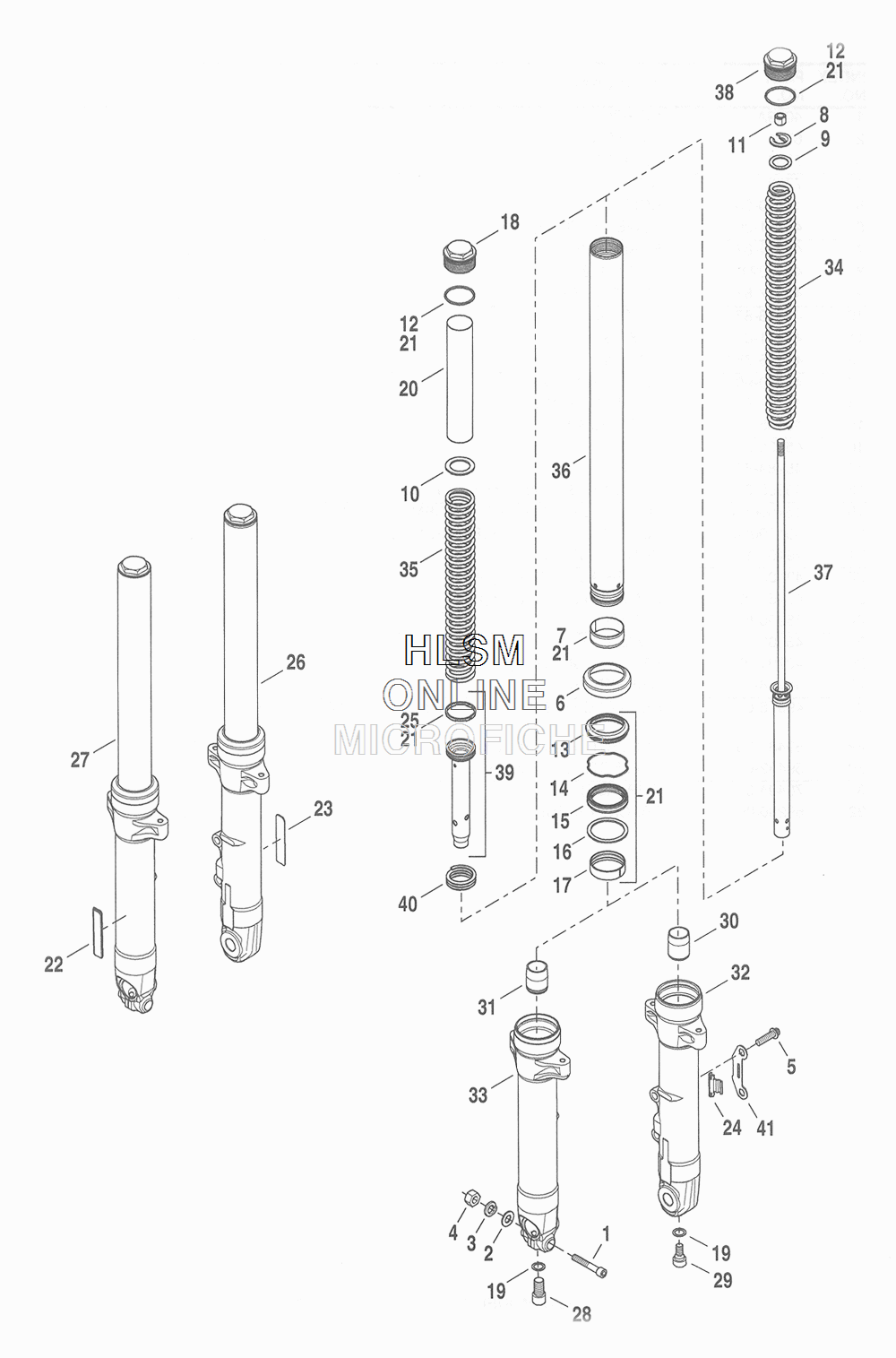

What year model do you have ? If I remember correctly, a 'cartridge' was used in the left hand side
from around ~2016+. Here's an image of the parts breakdown from RonniesHD microfiche...
hth,
T.
