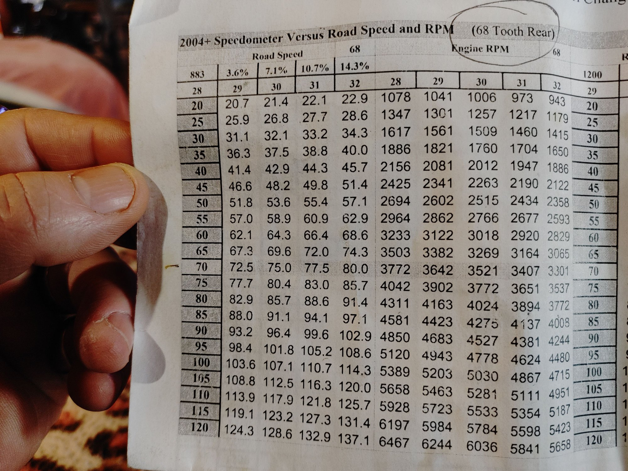

i also have the 29 tooth factory pulley i will never use again.it might have 4k miles on it
