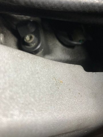

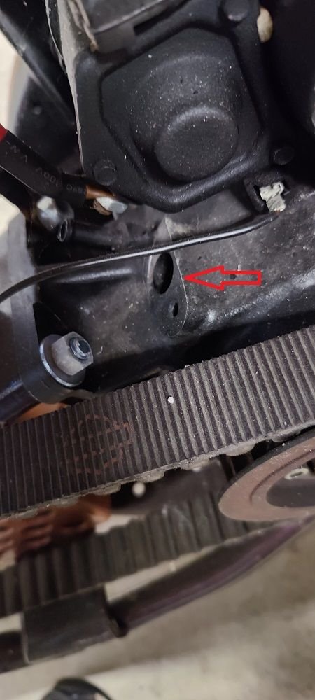

I just purchased this a project bike with a 97 Sportster 883 engine. Trying to figure out what is missing in this picture. I have been through the shop manual a few times and don't see anything like this.
This is between the starter and the rear engine mount.
Thanks in advance!

I don't have that on my 1991, but I'm going to guess it's where your speedometer sensor goes. They got rid of the front wheel speedo cable in 1995 IIRC.

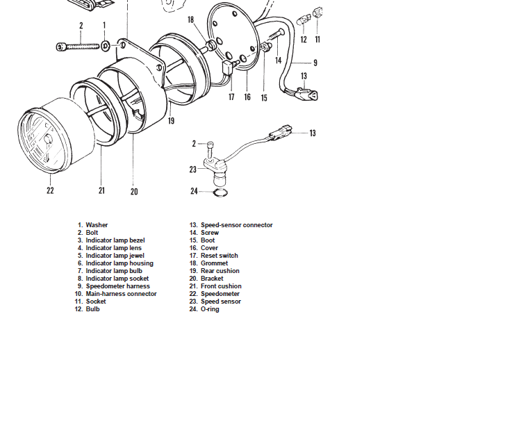

Speed Sensor.
#23 below

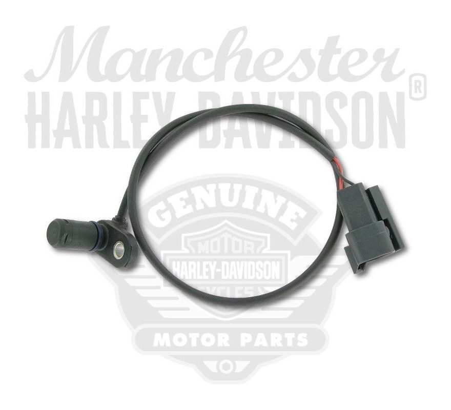

The H-D part number for the Speed Sensor on a 1997 Sportster is 74402-95B.
