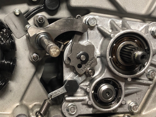

Could be the shift detent wheel clip. The detent wheel keeps the shift drum from moving, which keeps the transmission in the gear selected.
The detent wheel is held on by a crappy little clip that is prone to breakage, when it breaks the detent wheel flops around letting the shift drum move.
The detent wheel looks like a star, you can see the clip in the photo. the detent is located behind the clutch basket.

I appreciate the input friend, its just that its not a clip that i had found in the cover its a small steel rod.
