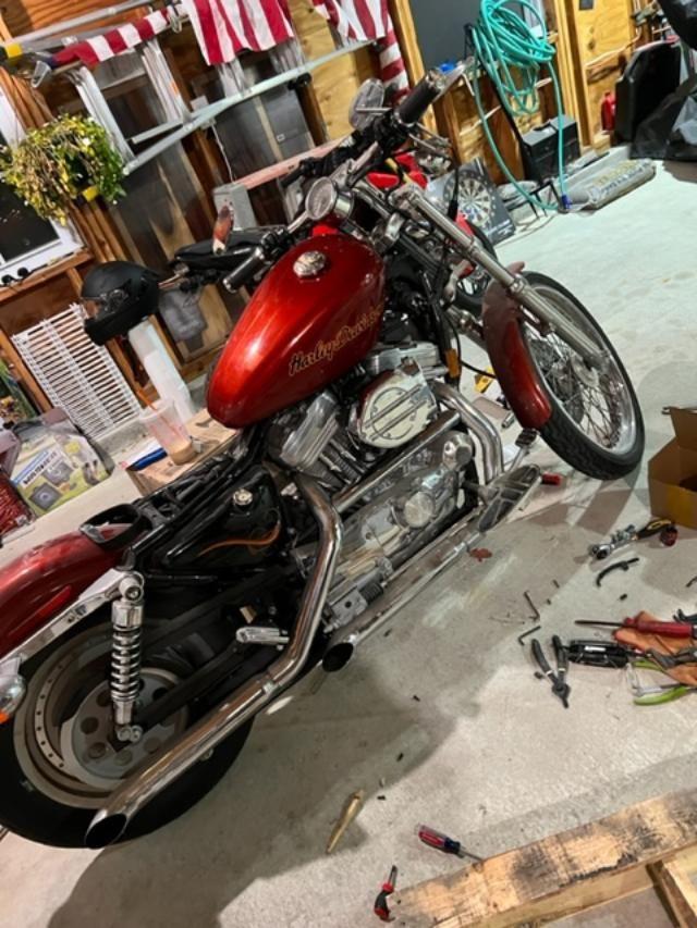

Hello,
New to Harley Davidsons and to motorcycles in general. I have a 1999 HD Sportster 883 with 7900 miles on it. I know really nothing that was done to the bike as it was my wife’s fathers that had passed away and has been sitting for 2 1/2 years. Ive taken it upon myself to learn off of it to get it to riding quality again. Ive been running into several issues, some that I've learned and fixed and some that ive been trying to find info on but cant seem to pinpoint it. At its current state, I've gotten the bike to start and does idle. It seems to me that the bike may have a fuel mixture issue and is running too rich? It has an aftermarket intake on it (Hura-something) and screaming eagle pipes. New spark plugs became black after i let it idle for awhile. Ive read about doing a "re-jet" to the carb but, learning as i go its all confusing to me. Wondering if you guys could shed some light on this, been reading everything i could find. I will try to attach a picture of the bike as well.
I apologize in advance if i left anything out that would be useful.
Heres what I've done:
- Cleaned out gas tank of old sitting gasoline and cleaned petcock and screen.
- replaced carb since old one has rust and junk it in (will rebuild later)
- replaced choke (old was broken and would not pull out)
- ran new vacuum lines and fuel line (old were dry rotted)
- replaced ignition (lost keys when he passed)
- changed oil and filter.
- Changed spark plugs (cleaned both boots for better connection.)
Thanks,
RJ

Nice bike and good for you on restoring it!
Do you have a Factory Service Manual? HD or Haynes or Clymer is fine for your needs. You can find one on Ebay.
I would replace the intake manifold seals for sure, you may have vacuum leaks, and they are 22 years old. It's easy if you already know how to take off the carb.
Do you know what jets came with your new carburetor? 45 pilot jet and 170 mainjet should be fine for your 883.
Your airfilter is a Kurakyn Hyper Charger. Popular "back in the day" but pretty dated now. Upgrading might bring the bike more into the 21st century, up to you. Lots of choices.
Screaming Eagle mufflers and those "H' style pipes give good flow, no need to change them at all. I run the same setup with the straight tapered SE mufflers.
There are some good tutorials over on xlforum.net that you can learn about tuning. Look for the Sportsterpedia section for in depth knowledge gleaned from many old experts.
Good luck. Keep us updated on your progress.

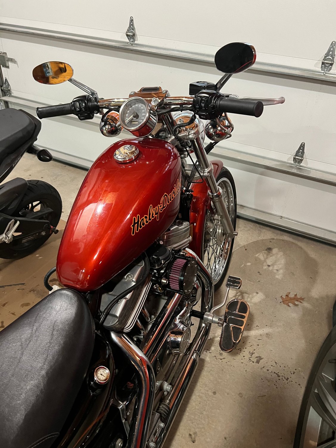

As a follow up. Replaced intake-carb / carb- manifold gasket, got a new intake, replaced grips, added a choke relocation bracket and adjustment screw to fuel mix and to idle. Pulled plugs cleaned them off and then let her run. Checked plugs when she cooled down no black so I might’ve gotten it adjusted correctly. But im hearing this knocking noise from what I believe is coming from below the oil tank. Also any two cents on a decent replacement gas tank as the tank is jb welded from a rust hole.
Edit: jets are back to 45/170
That's a real kick *** air intake. It looks like the Kuryakyn hypercharger blood groove design. I think its one of the best looking air intake systems on the market and I've heard nothing but good things. I'd buy one but they've been discontinued. I'll buy yours if you ever decide to get rid of it.
​​​​​​​Lots of used tanks for this bike eBay but I've also seen new custom peanut tanks for about the same price.
