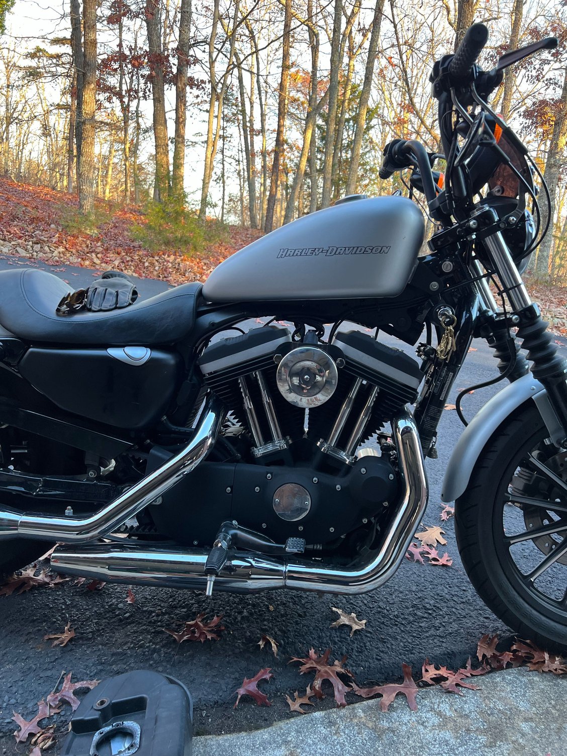

Hey all, this is probably a dumb question - I have a '10 883. Added gasbox customs 007 air cleaner, Also added breather bolts from Prism Supply. So everything went on pretty easily and lined up just as I saw in an instructional youtube video from lowbrow -
when I have ridden since then it seems all good, looks way better, but also there's like a deeper engine sound when i get hard on the throttle - it sounds more powerful or something? I also hear a faint swish noise sometimes which I'm assuming is the filter itself.
Is there anything I should be concerned with making sure I didnt mess up? I don't want that sound to be like, I don't know, engine pressure that's bad - or somehow ****ing up the engine otherwise
Probably a dumb question I just want to know what I can possibly mess up by having done this! Also - I have the stock pipes with the baffles punched. Bike pictured.
Thanks!

air cleaner side view.
