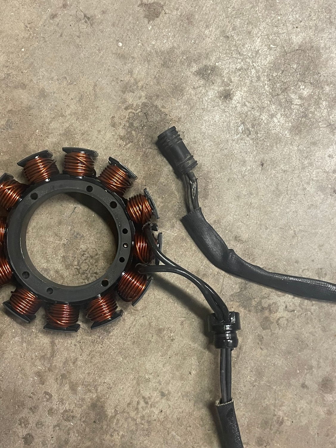

I ride a 2017 1200 sportster roadster. At the moment I cannot get it to start up. I recently replaced the stator and voltage regulator because it seemed that every time I would ride, the battery light would come on and then I turn the bike off, it would not start again. Replacing these parts did not solve the problem. The reason I replaced the stator is because the wire was burnt and exposed near the voltage regulator so I thought maybe bad voltage regulator as well. I will include picture.

Ya need to go back over what ya did and look for the problem with the shifter. Ya had to remove the primary to get at the stator, so check the shift springs. Might wanna run a Diagnostic Error Code scan for the fuel pump.
