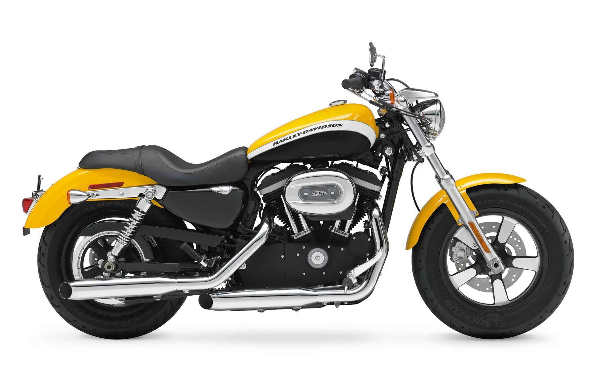

The XL1200CX Roadster seat will need to be changed when installing a 4.5 gallon fuel tank, the seat touches the rear of the stock 3.3 gallon tank and the 4.5 gallon tank besides being wider it is also longer than the stock tank. See the images below of an XL1200CX and an XL1200CA.
