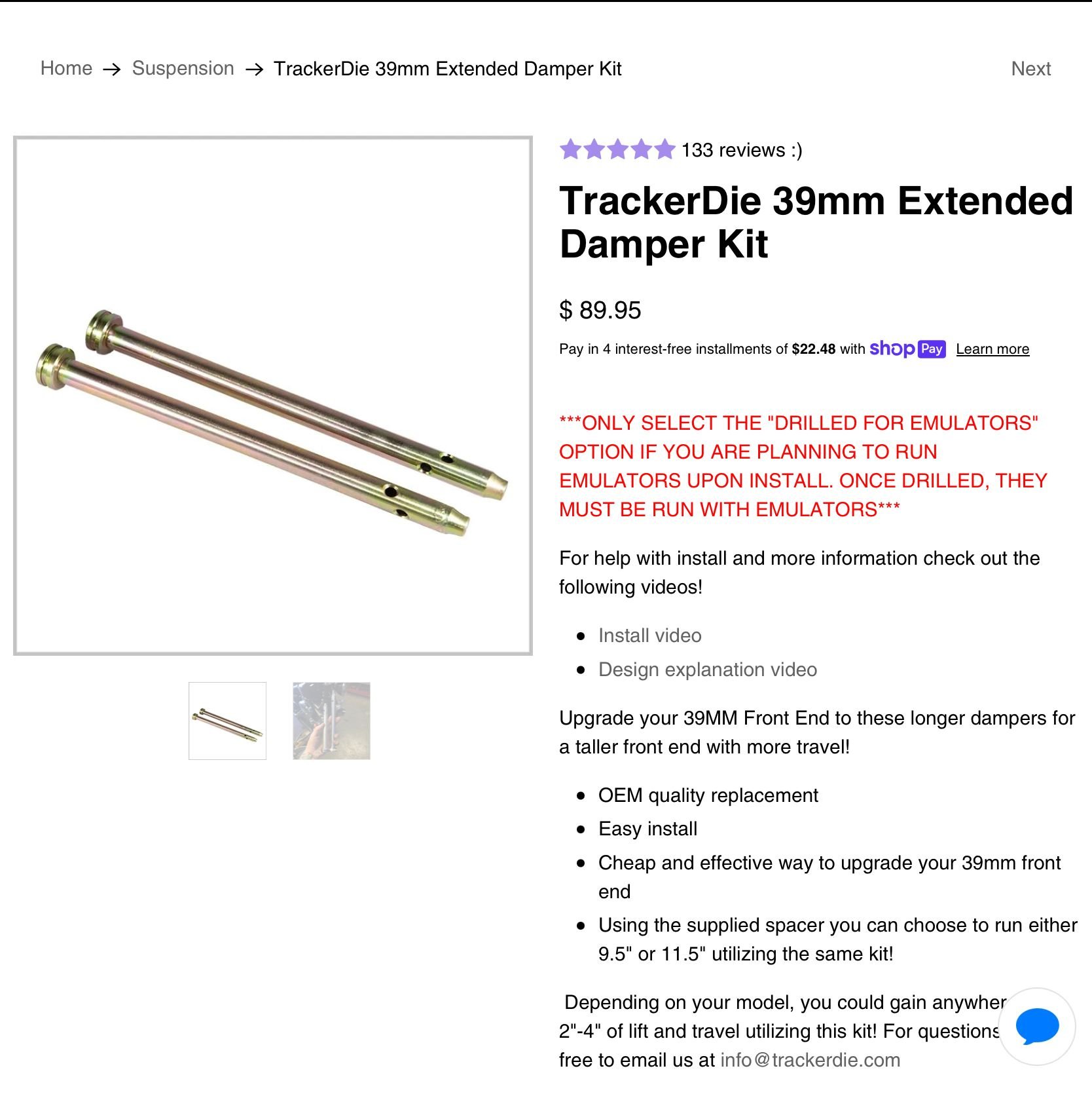

For the rear 14–14.5 is about all you can go.
Up front —replace the fork dampers.
