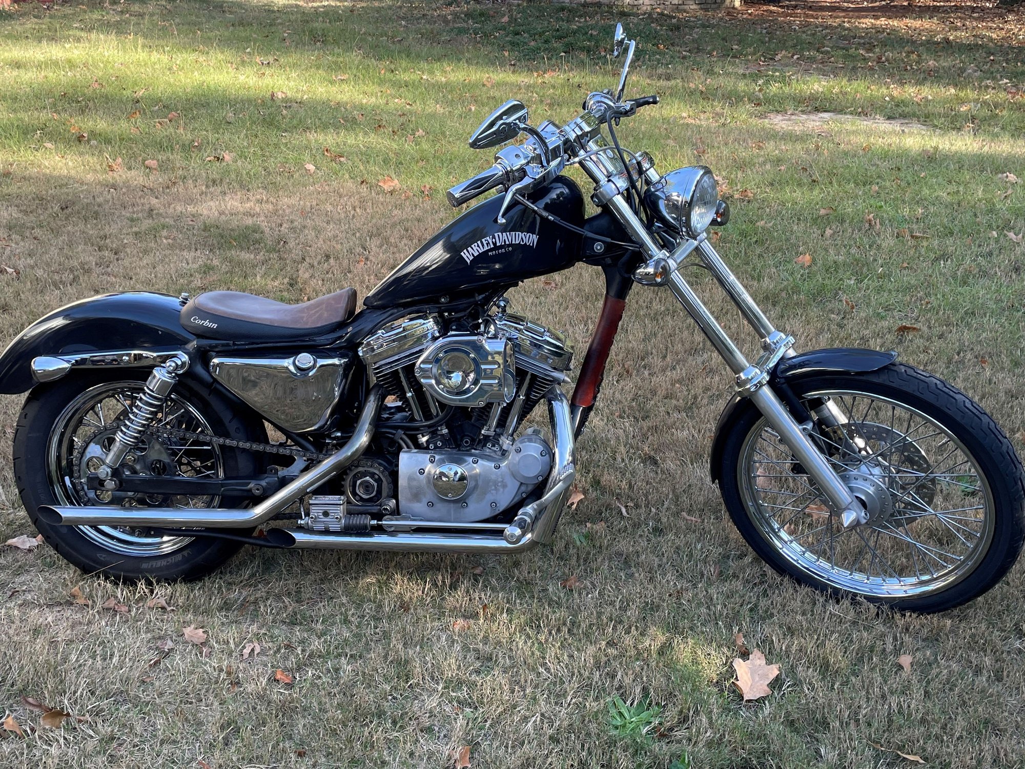

I am curious about the fall away method in determining if the neck bearings are at a proper tightness. I have a 2002 sportster with an aftermarket frame with the front end raked out. I am going to replace the upper and lower bearings on the triple trees for the front end. Reading up Ive read that the fall away method is the way to determine the proper tightness for the. Seeing that the front end is raked out more than a stock bike, how is the best method to determine the proper tightness and how to go about the particular method.

I would tighten up the bearings until you feel resistance when moving the forks back and forth and then loosen about 1/8 turn. As you say, the fall away procedure will not work as described in the manual with those forks.
