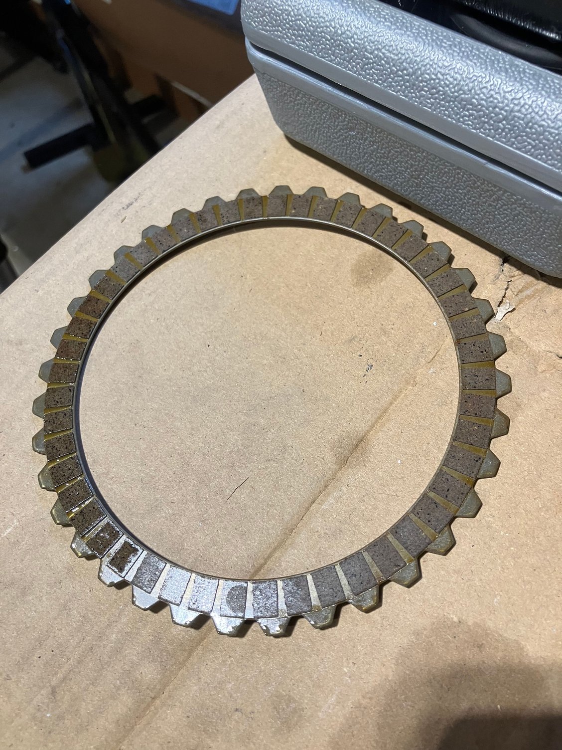

The next mod was to upgrade the clutch (Energy One), I had a flare on hard shifts and planning on a 1275 so it made sense to switch it out and troubleshoot before the 1275 was installed. I must have a Covid build because the Motor Company skipped out on soaking the clutch plates, the last three plates were dry, see pic. The new clutch works great no squealing or shuddering. The factory rivet plate was in good shape at 4.6K.

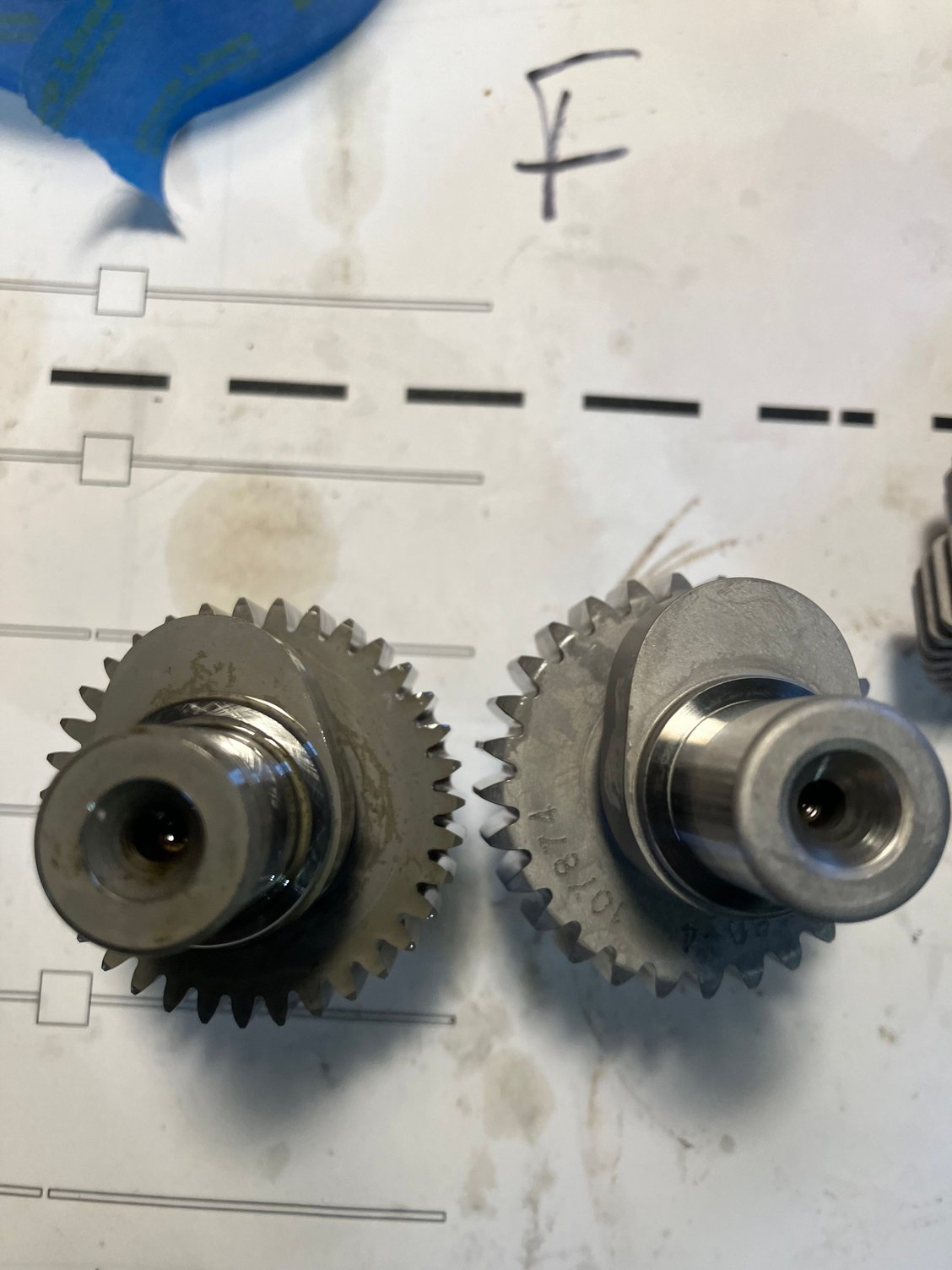

Pics of cam just to add some moto ****.

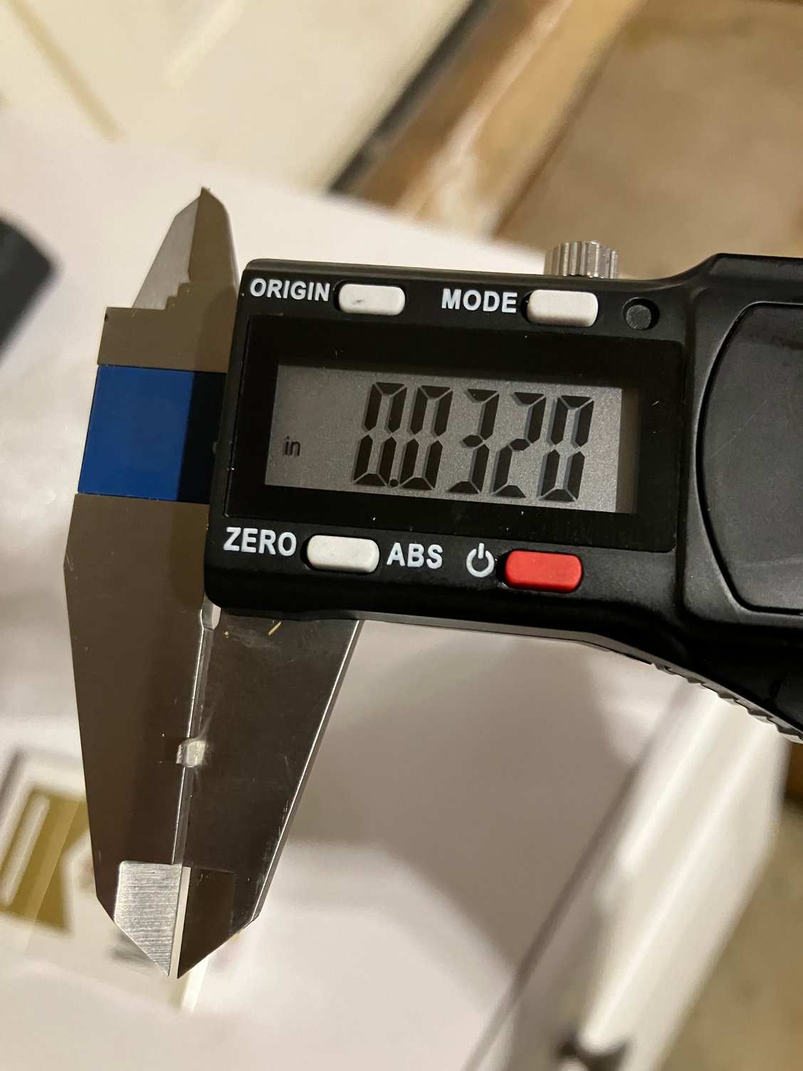

Buttoned up the top end after the squish test.
Those damn Cometic head gasket rivets were in the way, tried my side cutters and had to go to a cutoff wheel. Then fought the three pieces like a game of chutes & ladders getting the heads on, there's got to be a better way.

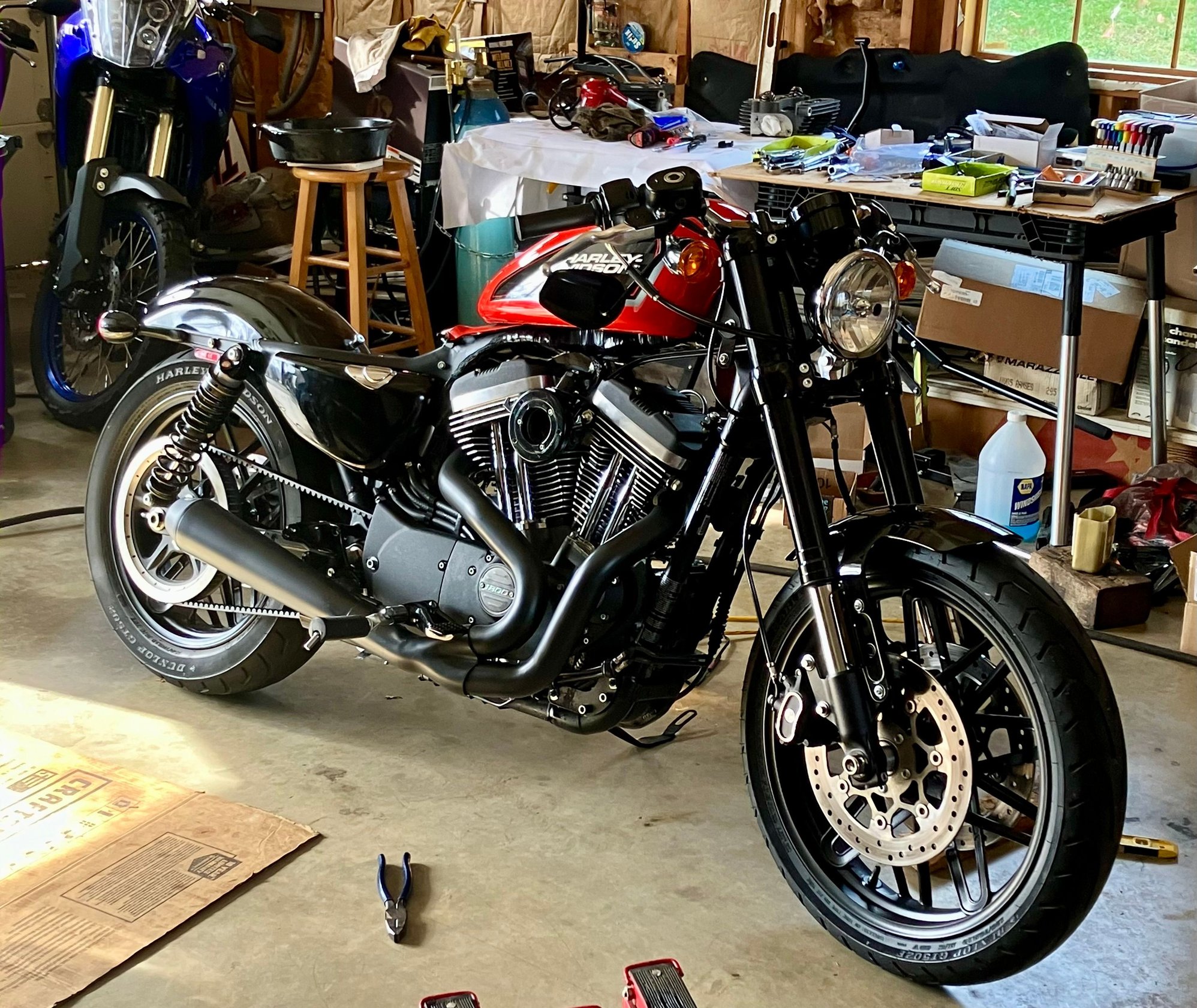

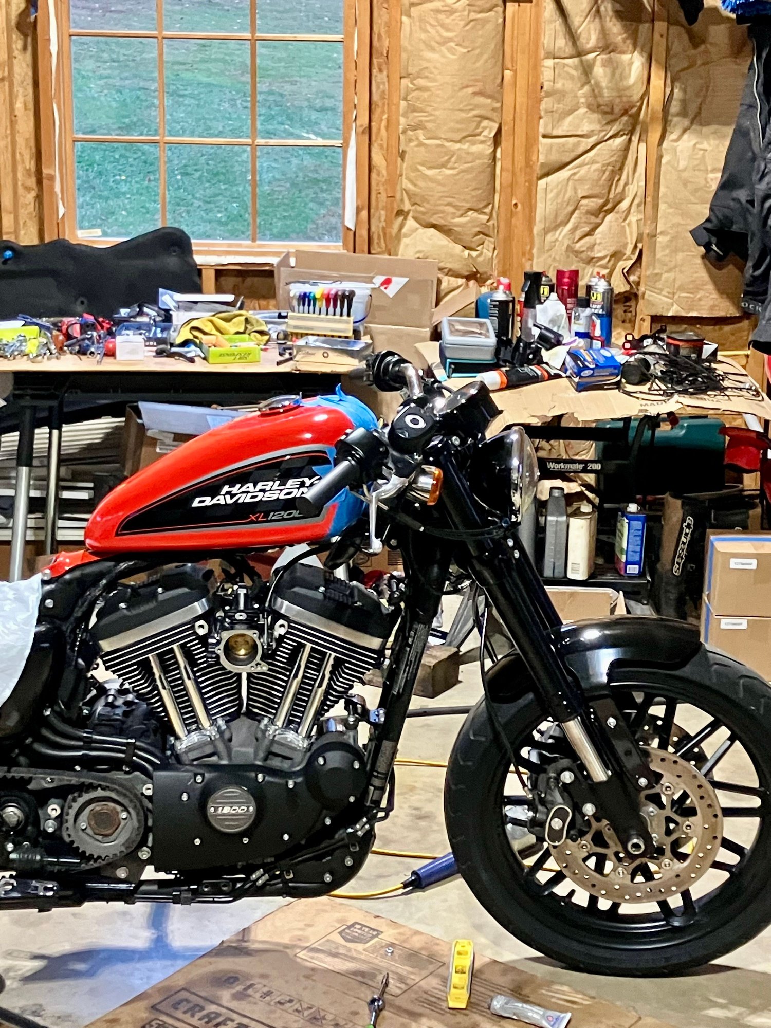

Yesterday was a good day, learned a lot. My reading and comprehension is (still) not very good - the exhaust flanges, which Hammer has a specific description and instructions on how the flanges are thicker and can hit with trimmed decks, somehow I read but it didn’t land.
That’s when I remembered that I snapped the motor off of the base on the shop grinder last summer using it as an improvised vice. Yea, I’ll weld it up later… A quick ratchet strap solved the grinder issue. The flanges fit after grinding, but the exhaust sits a tiny bit further down too, and I had the Cobra pipe tight to the cam cover when stock. Rookie mistakes, focusing on squish and pushrod length and missing the small obvious stuff.
After loading the Hammer tune (thanks Aaron), double checking my double checks I lit the candle. Fired right up, has the nice compression burble and the 560s have a great lope. I made it thru the 10-20-30-40 cycles in the afternoon with a fan assisting cool downs. After the 40 second cycle, I shut down for an overnight cool down. If the weather complies, I’ll get a ride in today.
