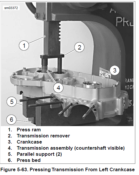

Also to first poster, the left side case were the trapdoor use to be had a small plate that appears to be a retainer to let cluster come away now towards inside of case.
And after reading my 2009 Sporty Service manual, one really needs a service manual this deep into it. in my opinion.

Too cool ric47v8. I searched and searched for that. He calls it a bottom end on his YouTube . I'm in Fl for the winter. Had to get my son to send me the picture out of my sporty service manual in VA I had posted above..
