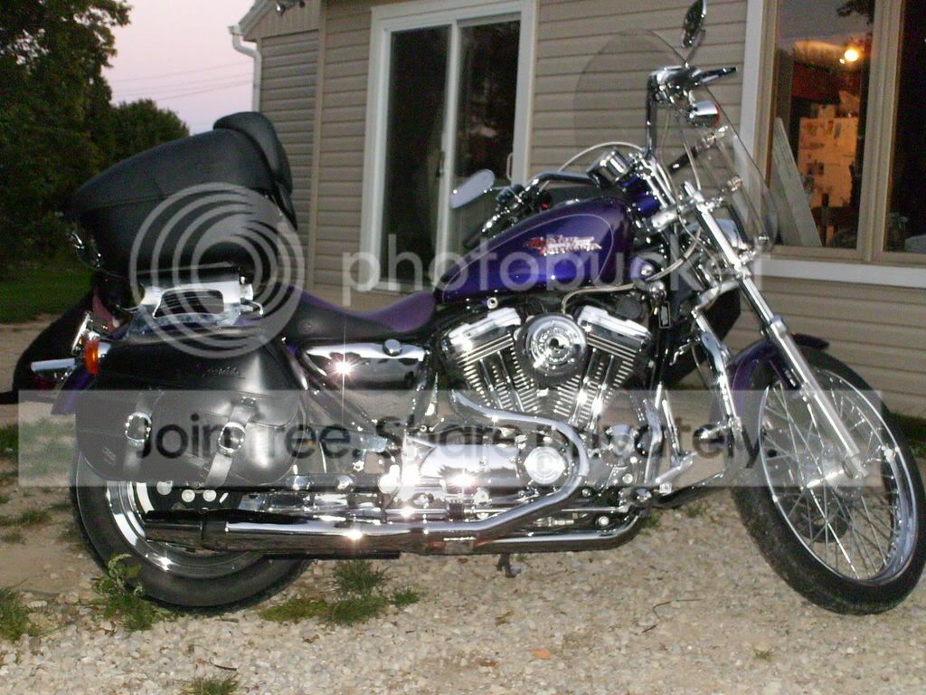

The parts say this pac and rack are for a 2004 and new sporty but with a little help from a press and so creative thinking I was able to get this tour pack to fit very nicely on wifey's 1200c tonight.

Not bad man. Should come in handy for the long hauls.

Looks pretty cluttered! How much work is it to remove when not needed?

Looks like a nice road trip is in order

Very clever and, good looking to boot. All dressed up with places to go, things to see. A definate "custom cruiser".

The pac is removable just a quickly and easily as the backrest is, just a little heavier and bulkier. In fact her pac is easier to remove then mine is.

What did you have to do to make it work? Is it just using the quick detatch hardware? Any modifications to get it to fit?

The rack the i used fits on the quick detatch hardware for the backrest after you give the rac a little massage with the bender. the new sportys have a wider fender on them and all you have to do is queeze the rack in about 1" to work. the rack is made from one piece of metal that is shapped like an upside down U so after you give it a squeeze in you have to get the bottom squared back up again. really easy to do for anybody with a press and some knowledge. mine also managed to get bent and did not affect the chrome finish at all which surprised me, I was fully expecting to have to get it rechromed over the winter.
