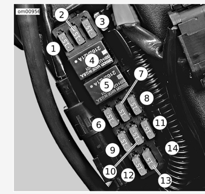

I have a 2008 with just the normal side cover. There is no special little cover that I can see that covers the fuses and relays as an addition.
The fuse holder on this bike hasn't corroded. The fuse pins go black because I suspect they are silver of some sort and not tin.
I don't know what others have done to promote corrosion or where it is forming specifically.

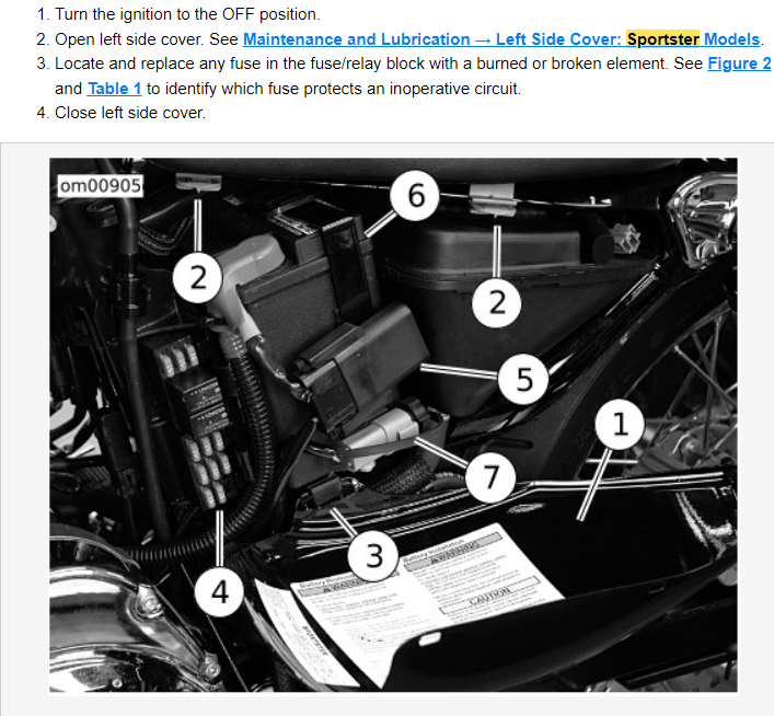

It does not appear to have a cover over the fuses except for the left side cover accordind to the owners manual.

Problem is, once the cover is in position, I could see the bottom of the fuse box sticking out from below the cover. If you get caught in rain, the fuse box is bound to get wet!

The 2008 has been out in quite a few rain events, some quite heavy, one lasted for 300 miles.
The bottom left corner is exposed but it hasn't suffered.
Just a thin smear of dielectric grease on each pin before inserting cleaned fuses.
