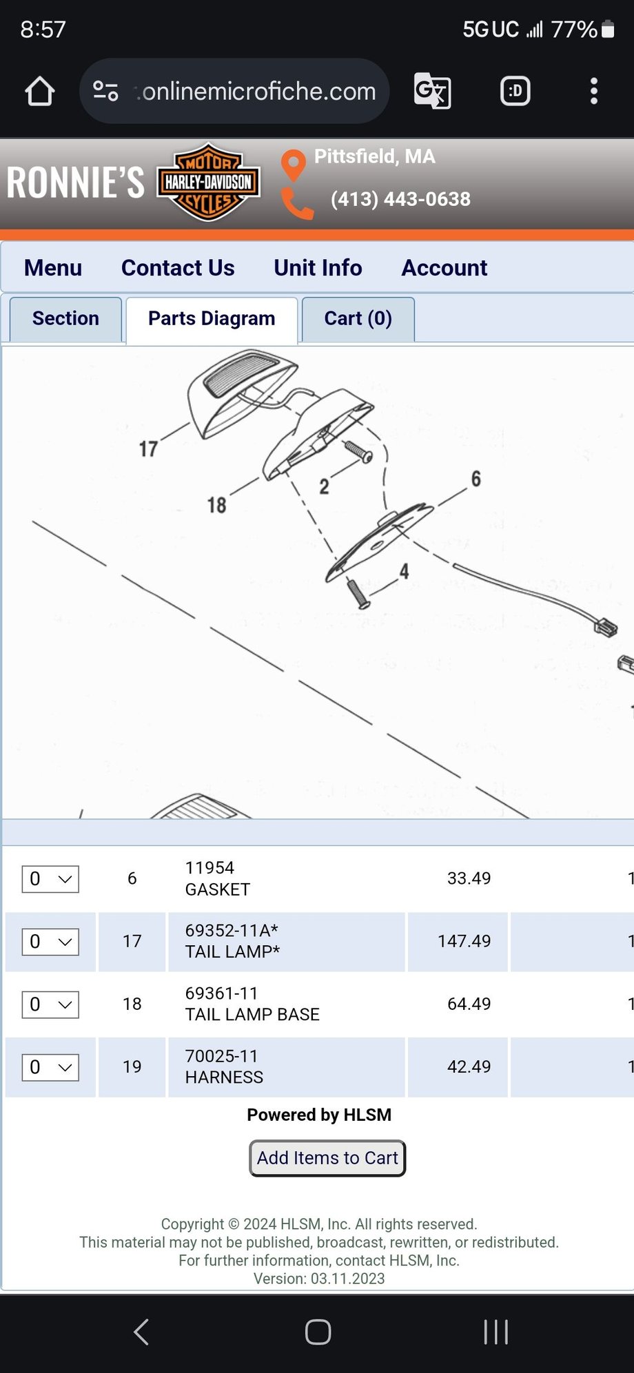

Isn't the 2014 Custom the one that comes with that atrocious LED lamp? No bulbs to replace.
If any part of that has failed you will need a complete new lamp.
Genuine Harley-Davidson Sportster 1200c Tail light 11-20 69352-11a | eBay

I have a 2014 1200C and yes, the there should be a rear running light illuminated when the bike is running. As @Andy from Sandy says, you need to replace the entire assembly, unless you're gifted in electronics and can figure out a way to fix the one you have.

What stupid about this is designing something the cost $150 to replace a light bulb.
