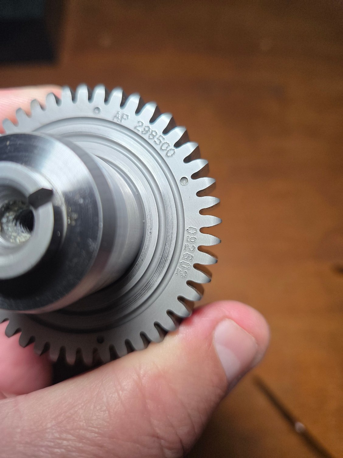

Originally Posted by OCSpringer
Are you meaning marked as in 1 through 4, such that 2 of the cams are swapped, or marked as in maybe they are a different grind and not the 560 cams. Both of those things crossed my mind. I'm going to check the box the cams came in. As for maybe in the wrong order it looks like that would be obvious based on where the dots are placed on the cam gears, ie some dots are on the gear others on the base.
The lobes should be marked HP560-1/2/3/4. Was hoping you saw that.
Are Hammers cams made by andrews? Just noticing in the picture I posted the cams have an andrews part number but it doesn't really match up to anything in their catalog.
Yes. And they too have been known to make human errors. Rarely.

Originally Posted by aswracing
A more aggressive cam would result in less compression. A less aggressive cam would result in more compression. So it's the latter possibility I'm trying to eliminate.
I do have a set of Andrews N2 Cams and my first thought when I saw the AP serial number was maybe I put the wrong cams in.

OK now I am confused. Here is the N2 Cams I had in my other motor.
Same part number as the Cams Hammer sent me. I was not expecting that. Maybe thats not the part number.
Here is the box they sent me.

I think that part number is for the #2 drive gear, not the cam set.

You are correct. I did find a picture of a set of N8 cams and that cam had the same number.
