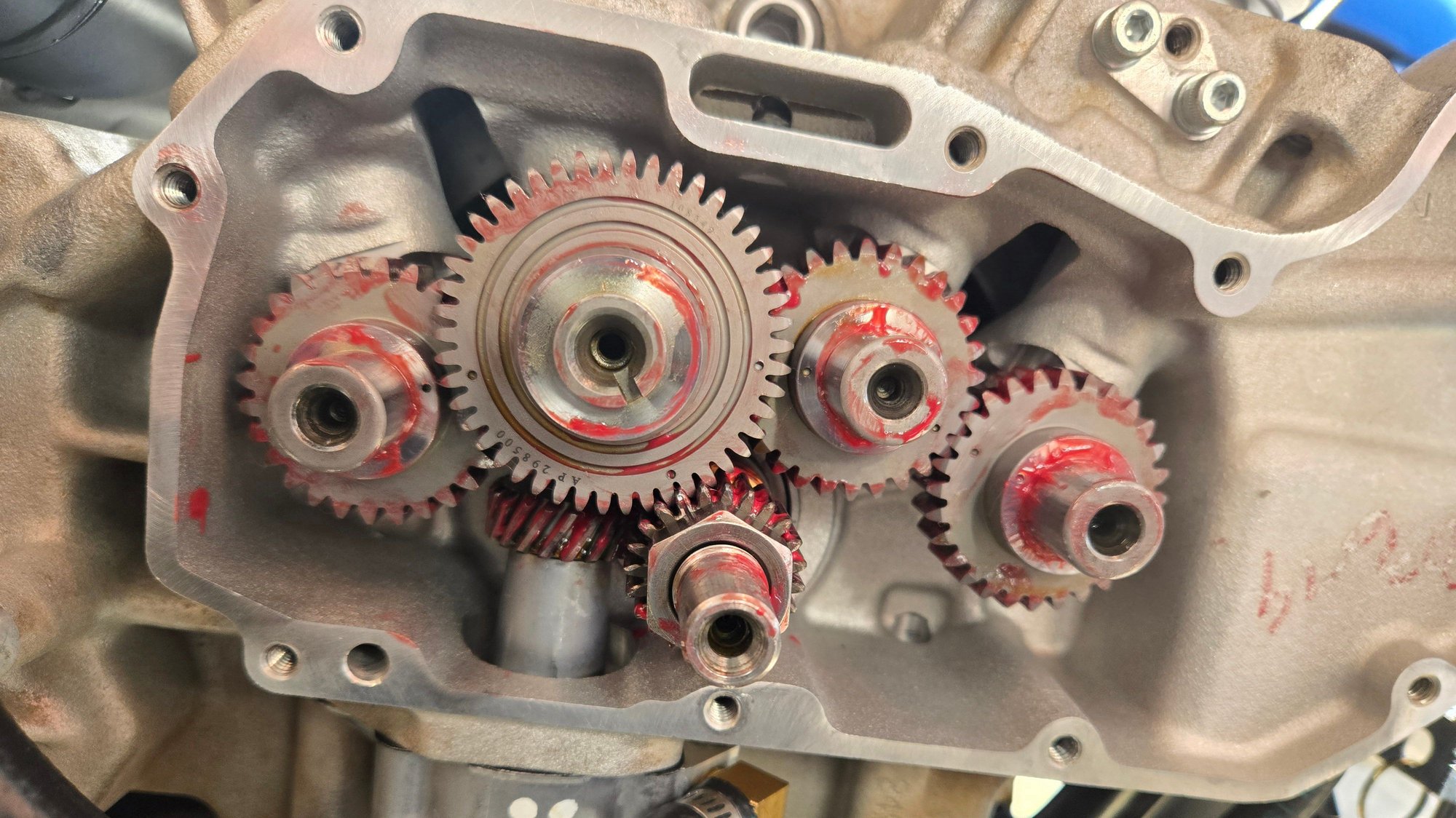

So, I would have to ask - (as Arron mentioned earlier) who did the cam install ?
Is it "off by one tooth" ?
good luck,
T.
I did the install. Everything looked lined up right when I installed it. Below is a picture of the CAM install. All the dots line up.

10.5:1 with the 48 degree IVC of the IMPACT 560 cams, the 3.600 bore x 3.813 stroke of the 1275, and the 6.926 rod of the XL, works out to 198.5psi, at 64 degrees and sea level.
Keep in mind that this is not the first 100hp package HP has ever sold. That package was very carefully designed and tested more than 12 years ago, it's an enormously popular package, and they've got literally hundreds of happy customers running that package in all corners of the globe. The package is well proven. An issue like this is an anomaly, not some fundamental design issue.
There's a reason behind it, it just has to be found. And that ain't always easy. Like I said, if it was mine, I'd start by taking a close look at the cam timing. That's an easy mistake to make and this is the exact symptom it causes.
If all the marks are right, I'd check to make sure the pinion key hasn't sheared and allowed the pinion gear to move. This is something else that'll screw up the cam timing.
And I'd make sure all the lifter preloads are correct. A short pushrod will pull back the IVC and raise compression, although it'll also make a racket. So if the valve train is quiet, this is unlikely.
I'd also double check the compression tester against another one.

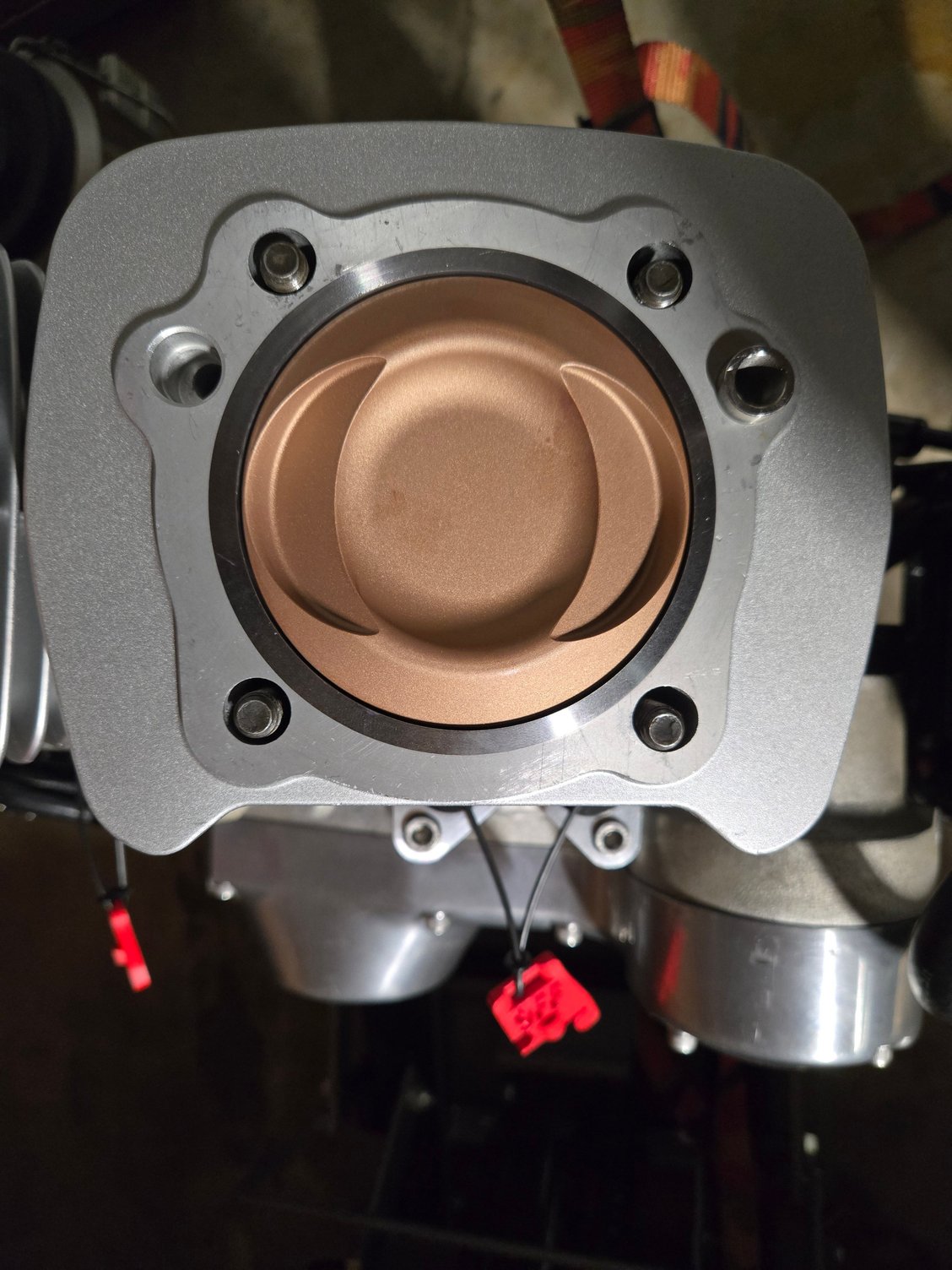

Did you happen to take a pic of the top of the piston, or the underside (where you'll find the part number) for that matter? It's always possible there was human error in pulling the correct pistons off the shelf.
Old Jan 26, 2025 | 01:10 PM
OCSpringer's Avatar
OCSpringer
Joined: Aug 2019
Posts: 1,843
Likes: 1,940
From: Santa Ana, CA
These sre the tops. I don't have a pic of the bottom. This pic is from the bad cylinder I had so disregard the fact that the cylinder is cockeyed.
