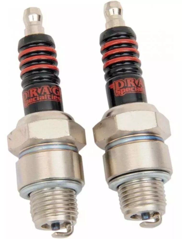

This is what I'm using in my '16 Forty Eight:
https://www.denniskirk.com/drag-spec...rd/2009272.sku
Do you not have a tuner as well?
FWIW...these are 6R12...

I'm using Drag Specialties E18-6655SDS plugs in my 2011 XL883N, they are equivilent to NGK DCPR7E plugs.
In installed the Drag Specialties plugs in 2019, they have performed faultlessly for six years so far.
