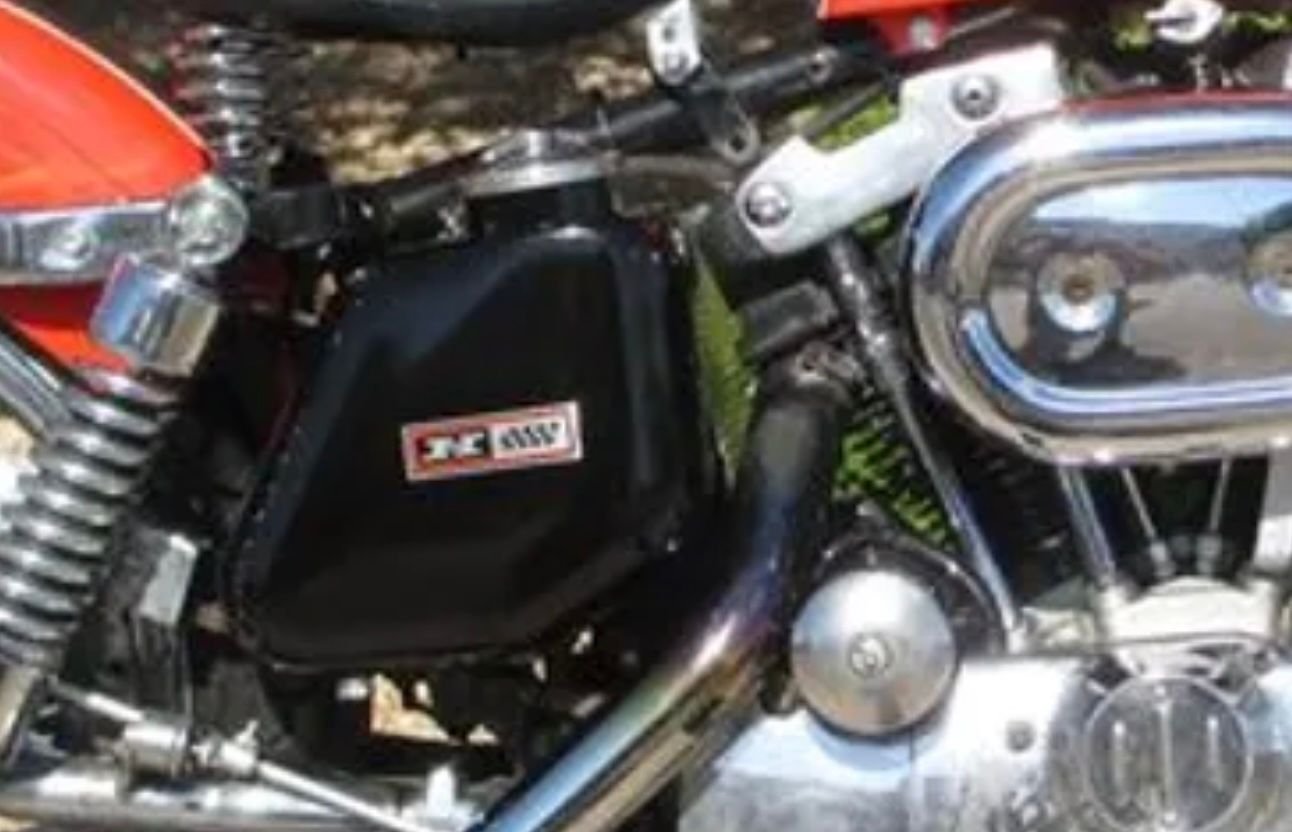

Then it's not a factory tank/cap. Post a picture of what you got.
Here's a stock tank, the lever loosens then the cover comes off. In it is the drop-in filter.

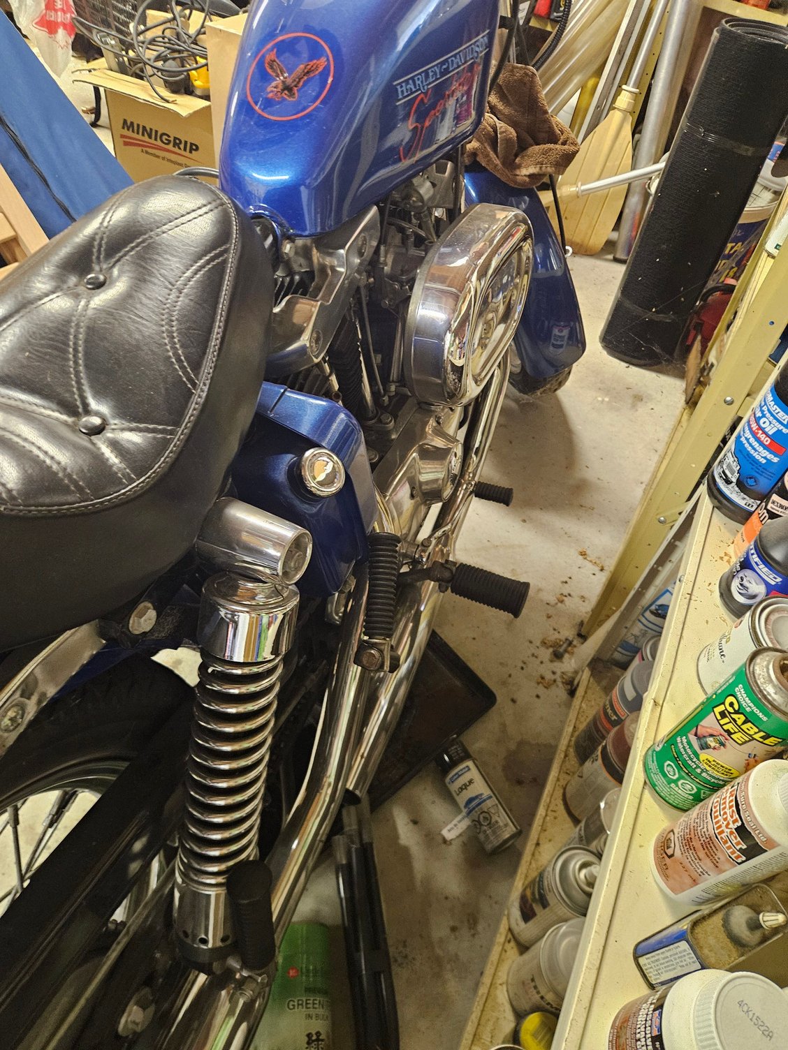

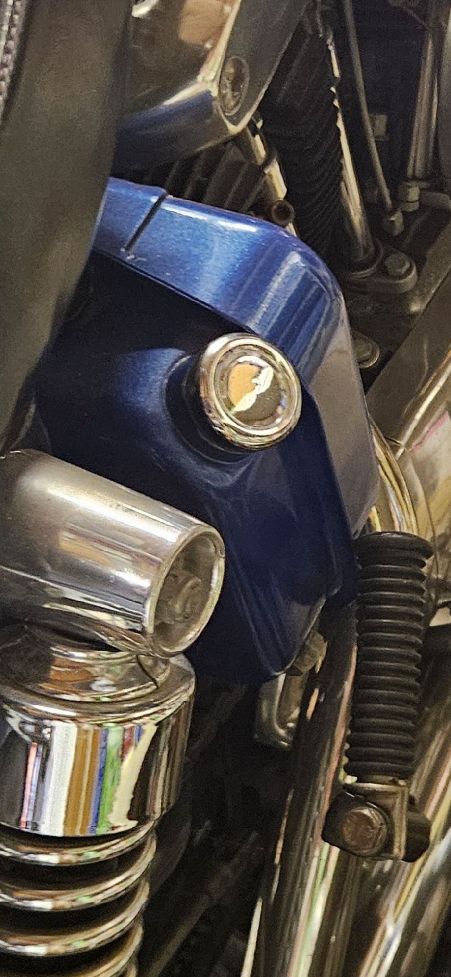

Default 73 Sportster XLCH
This is what mine came with and the tank looks different than yours as well. The chrome cap youbsee there has a dipstick atrached to it. Thanks

I missed that it was an XLCH, the picture I posted was an XLH. No oil filter then unless someone cut in to the return line and installed one.
