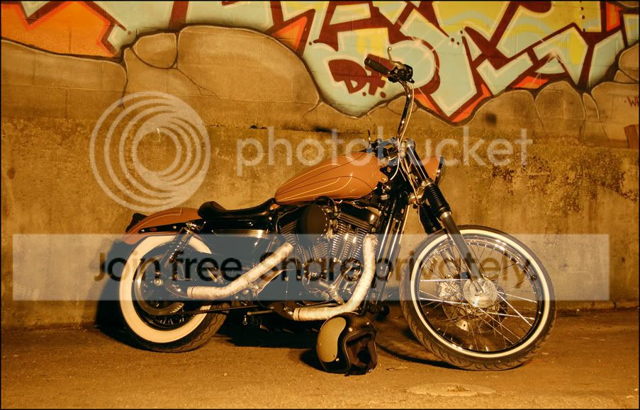

The bike is STONE STOCK otherwise. I can't give you any info on speed/RPM as I have no Speedo/Tach.
As for my aircleaner, here's a picture.
Rev limiter? No. If you pin the throttle, and keep it held, it will keep revving, even though it's breaking up BAD.
