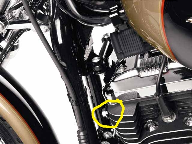

I'm probably calling it by the wrong name. This isn't my bike but what's circled is the bolt I'm talking about.

So...any one know the torque specs? Or if this leak is an indication of a serious problem?

Believe it or not, I just noticed the exact same thing on my bike. Same bolt too. It dripped enough to stain the floor with a spot. Anyway, spec is 55-65 ft. lbs. (74.6-88.2 Nm). It's a 5/8" bolt.
