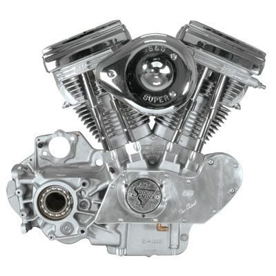

Well the best way to achieve all your goals is an S&S sporty motor. It only takes a little frame modding. You will need to put a little clearance in the top tube for the rear rocker cover to clear. Lots of information on this on the web and in other forums.
S&S Sporty
