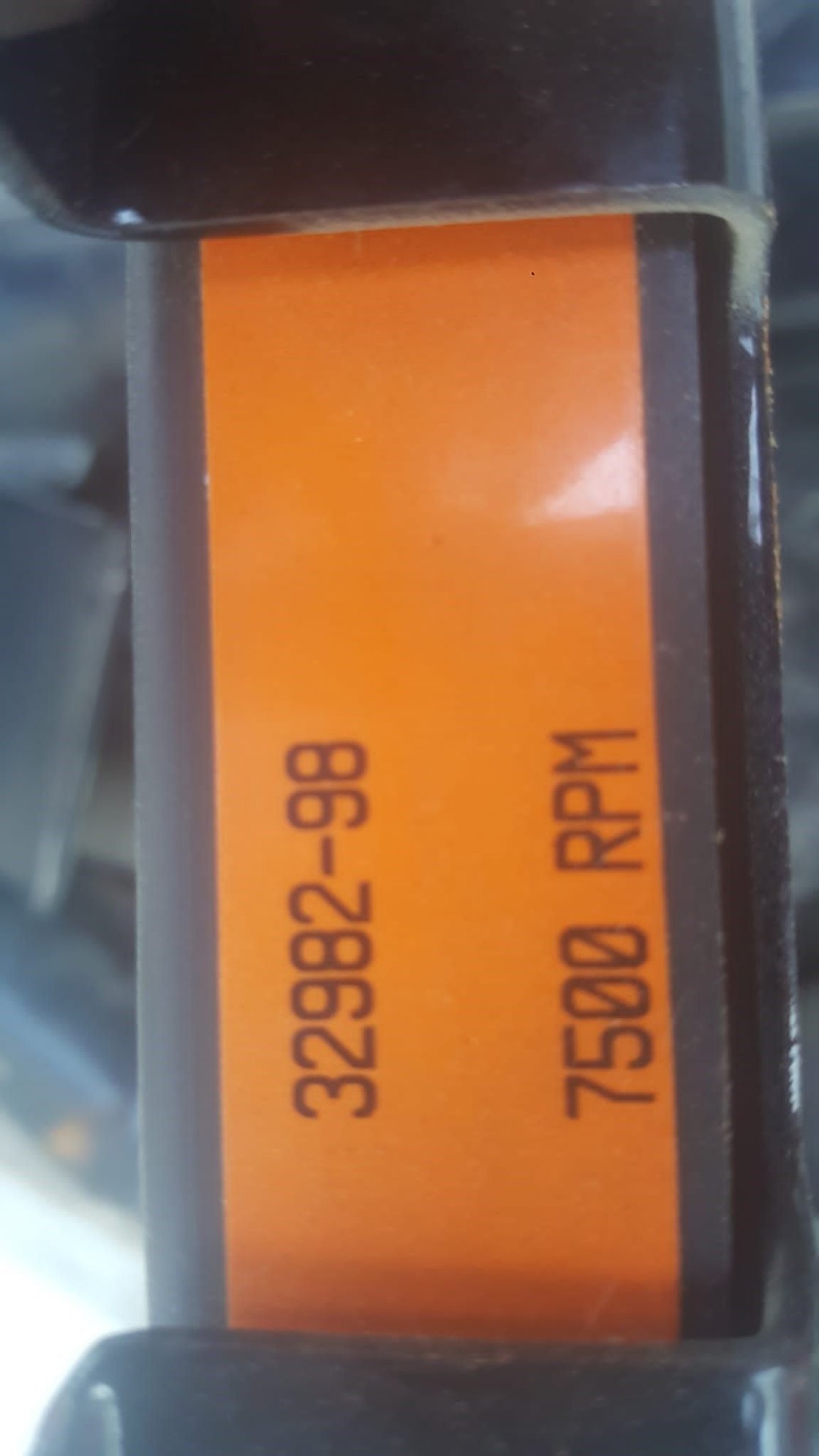

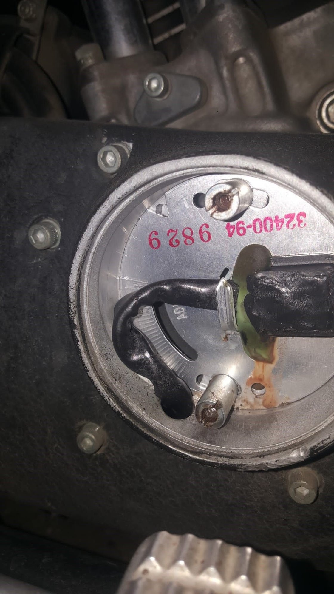

My friend owns a 1200 S, 1999, and it has the ignition from the pictures attached.
We would like to ask, please:
  1. It looks Screamin Eagle ignition, but is this the stock one?
  2. Is it possible to cancel the VOES and install a mechanical advance, with this ignition?
Thank you in advance

Nope no advance with that setup., see the crud leaking down off the pick up ? Means it's toast needs a new one, they are going out when they start oozing the goo like that, common with those.

nope- not the stock ignition module either- its an SE version you could purchase. I still have one in a box from when i owned a 98 1200s.
