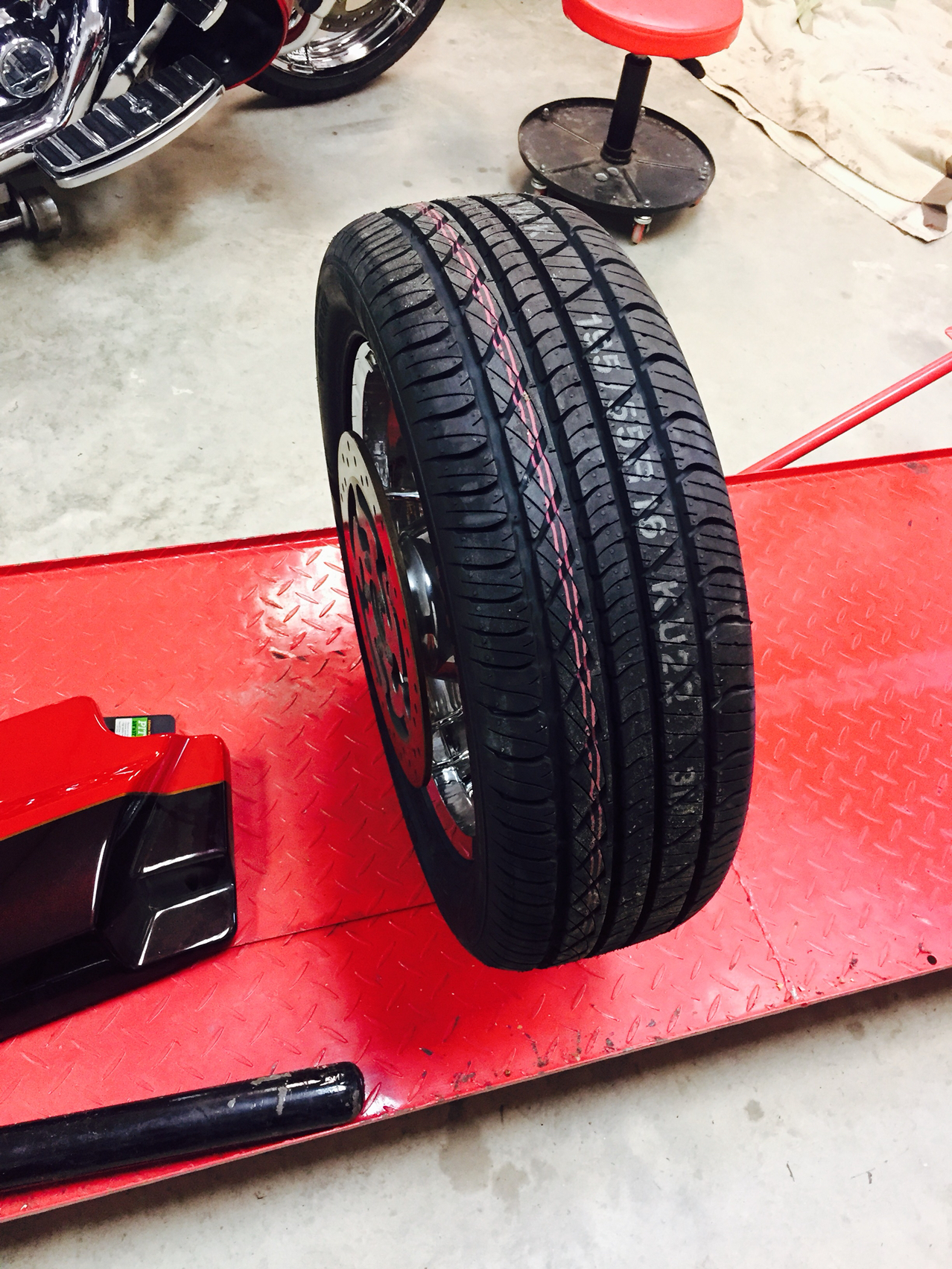

How much ride on is needed with a 195/60-16? Just wanted to make sure I ordered enough .I am placing my order tomorrow morning for a 195/60-16 Kumho Ecsta PA-31. Any advice on my choices and how much ride on I need would be greatly appreciated. I'm excited about finally making it to the dark side.

This is the same tire I'm running. 37-38 psi works perfect for me on this tire. The bead set really easy as well. I think it seated around 30 psi. You'll need 2 bottles of Ride On.
Attachment 594532Attachment 594531
I greatly appreciate the info. Looks fantastic. So two full 8oz bottles of ride on? For a total of 16 oz? I'm excited to finally make the change

Yes 16oz total.
