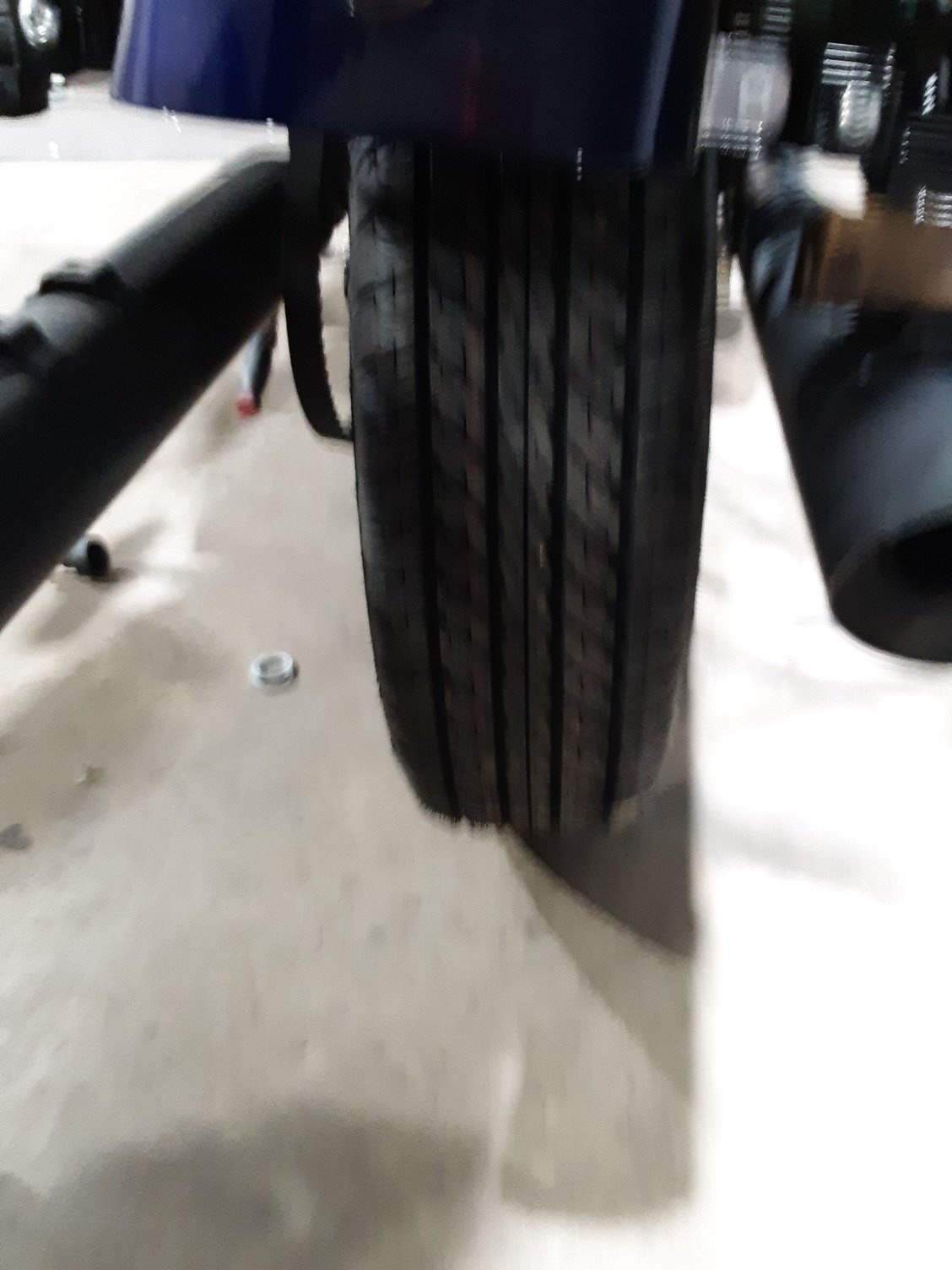

The text you posted seems to be from one of mine on my 2017 sidecar rig when we decided to switch to a car tire. 195/60R16. That bike had a 16 rear and 17 front fractory . It worked very well. The New frame (2009 up) is a lot different. Making it easier to do.
On the 2020 with sidecar it was a little different due to factory wheels being 18 inch. We did get it worked out and it works perfect . Required a new new 16 inch wheel and a 195/65R16 to get everything as it should be. Most anything can be done if you are willing to keep at it.
We have a Car tire on the rear of a HD 750 street and matching car tire on the sidecar. Last week when I removed sidecar from the 2020 RGL for a bit I swapped out the wheels and put motorcycle tire back on . Quick easy job.
I do not personally recommend a Car tire on a two wheeled bike. I have done it and so have many others. I just see no reason for it with the AE 180's on the new bikes. 20,000 miles on rear even a little more some times makes it not worth the trouble IMO.
2020RGK with 195/65R16
