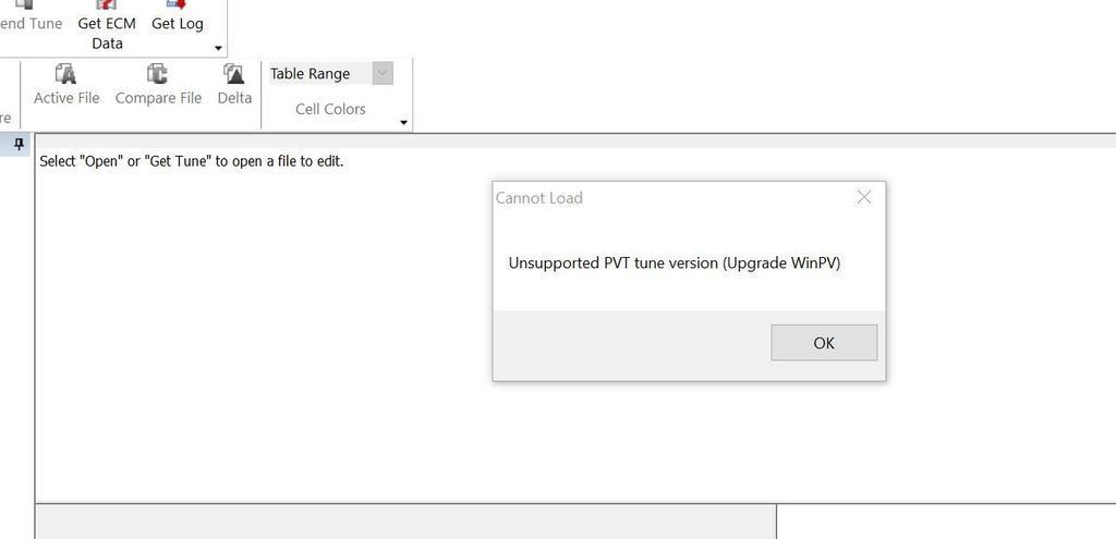

****, I can't even show you what I have...
Try the new version from their website.
