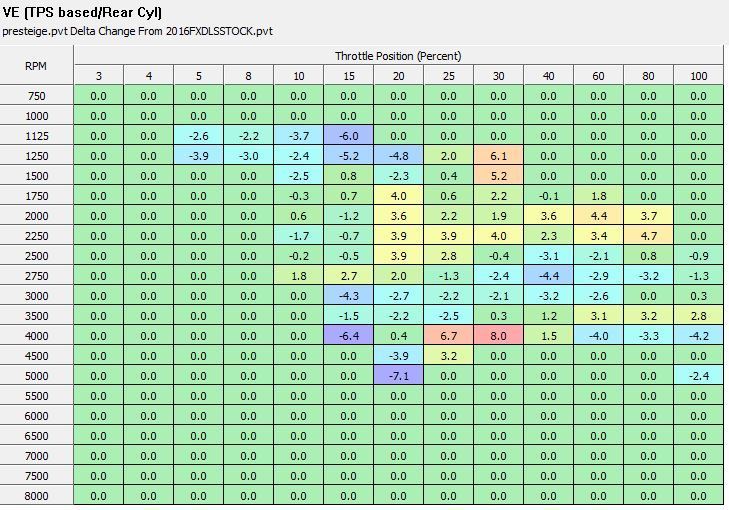

So here is where I am: Picked up the bike today. Shop said they are having problems with some of the 2016 bikes. No problem with their equipment and on other bikes... And they couldn't produce a printout of my tune, but once they sorted it out they'd re-run it and produce a printout. But even so now I won't ever have a "before"... Yay.
AND
Even though I bought a new license for my PV, they couldn't get it to work with my bike (though I have it married and have uploaded a few tunes no problem) and had to buy another "tune license" from Dynojet. I argued that I had already bought a license, used it and had no problems. They stood fast, saying it either wasn't the right license, or for whatever reason couldn't get it to work, so they bought one and added $199 to the bill. Lovely. My $425 tune just turned into $625.
AND
I still have decel popping and the bike doesn't feel any better then when I brought it in.
SO
I called Dynojet and they basically called shenanigans on the shop. Said one license is all you need, and If I successfully loaded a tune, the PV works with my bike. I asked then to call the shop and talk to them about it, which they did, to no immediate avail. Dynojet asked me to send them a diag file from my PV. They also said one way or another they would take care of me.
So I looked at the new "autotuneXX.pvt" file i saw on my PV and saw the only changes from the stock HD tune that I saved when I married the PV was the below:
Rear cyl delta from stock tune:
Front cyl delta from stock:
And the AFR table was EXACTLY the same as stock:
I don't know enough about this, but I have a strong suspicion that beyond the license issue, I was screwed...
Can anyone with real experience with this have a look and tell me what they think about this? And I can post any other tables you need to see.
Thanks.

Don't get me wrong I understand your concern but finding someone to do a good or really good tune are few and far between.
Looking at the info you posted it looks like they just dialed in your VEs (something that auto tune does) and left the fuel alone.
Did they make any changes to your timing?
No, the only changes were the two ve tables and resetting the afm tables to the default - while I was waiting for the dyno, I lowered them a bit to richen it up a bit - now they are back to what HD/EPA set them to stock. That's another thread here...
