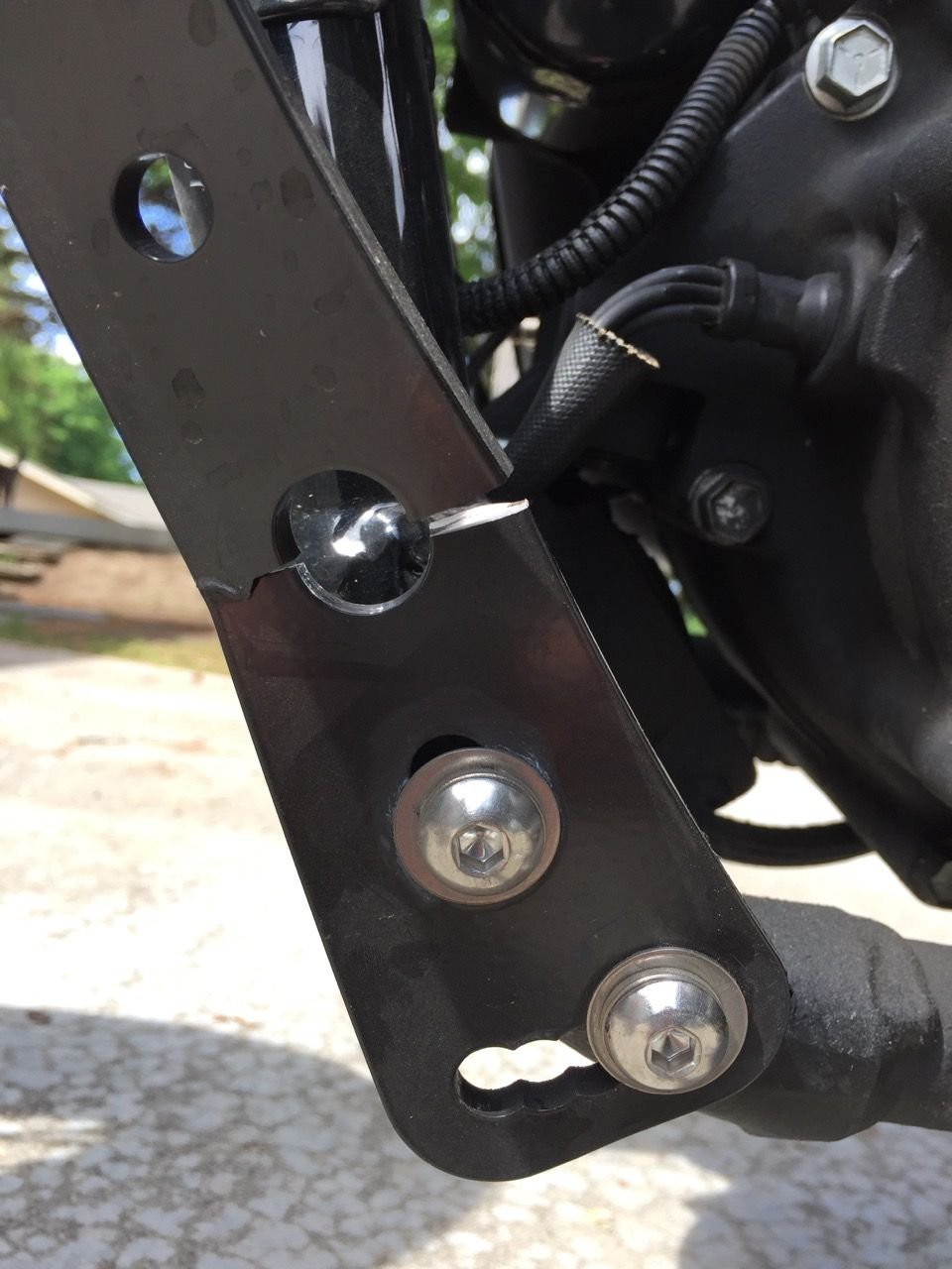

I got out for a data log run today. Attached are the data log and a copy of my current map. Thanks for the time you guys take to review this stuff.
In other news, this happened on my ride today.....
