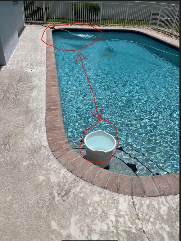

Yep, I've been told by the pool guys of the bucket test. If you have steps, place it on there so it's same temperature as pool water.

Originally Posted by TriGeezer
Get a bucket and fill it with water, and sit it near your pool. Then after a few days compare how much has evaporated as compared to the pool. Then do some magic magic math to account for the extra heating of the water in the bucket, and the surface area differences, and determine after the magic math how the evaporation rate of the pool compares to the bucket.
Ok M-Geezer, you dun a good 1.
See for yourself.................u r right.
I don't think I ever said that about you b4. That u r right. LOL!!!
See below.
It is evaporation mate.
Git ova here MG..... Proof positive. Thanks.........GOOD idea.
I take back all of the bad things I ever said about you before. naaaah, that is too much to take back. Oh OH......
LOL, I appreciate the bucket info...worked well.

I know where I live we have had squat for rain. Weatherbug App says daily 50-70% chance and it never happens. Been consistently above 90+ every day and with not many clouds so its killer fishing weather and also good weather to
cause a ton of evaporation. I'm glad yu found it to be weather related vs a leak. No fun chasing water leaks !! ☮️

Originally Posted by Hey Man
With all the rain we get here this time of year if you have to pump water into a pool instead of pumping it out I'd say you've got a leak!
Right. That is what instigated this thread. Thanks HM. After I think it was Mono-Geezer above said he learned from a pool guy to put a bucket of water in the pool on the top step or so and see if it is pool/bucket evaporation or if the the pool water goes down and the bucket of water stay up.
As it turns out my friend, The bucket of water and pool water level moved in tandem. So all is GOOD. 'juss evaporation.
I'll tell you another thing why it is likely evaporation. My lawn has started to brown. Not normal. So I increased the sprinkler times 5 minutes. Also IMO confirmation there is a longer and/or more intense heat causing evaporation.
