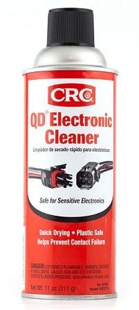

Next time use this on electrical stuff.

I use that or tuner cleaner... or as my dad says "tuna" cleaner. I don't know why I would need to clean a tuna when working on electrical conections but hey, whatever works. As for yamabond its gray in color so its not the prettiest. That black case sealer the op bought might look better and as long as it keeps water out it should be fine. Take some pictures op so I can see how it looks.
