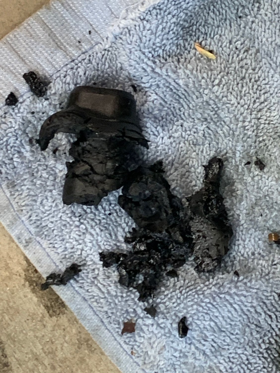

Check this out, the rubber part that rests in the inner primary hole is mush. The stator wire is fine, so’s the stator. The stator wires pulled right through with the stator without loosening the clamp.
allot of those little pieces are from the plug and were floating around it the primary.

One word, yamabond. It's the stuff used to seal cases on 2-strokes. It's very flexible and keeps water out. I put that **** all around the stator plug connector. In the past few years since putting a new stator in i've never had a problem. My old plug looked exactly like yours.

I’m more concerned about the why right now. I’ll be installing the new stator this weekend. And I don’t want it to happen again.

The why is because water or in my case some oil got in. It can cause a short and melt the inner plug. If you don't want to ask yourself why again in a few years then seal it up. 7/10 times a stator is replaced the stator itself is fine and the plug is completely burnt up. I went through 2 stators in 3 years before it clicked with the case sealer. Since putting that stuff on its been 4 or 5 years with the same stator. Oh and check your regulator. If the plug is shot get a new one.

New stator's in, easier than I thought, but I overthink stuff.
I couldn't locate the Yama bond you mentioned so I used some Magic Black, same **** different name.
