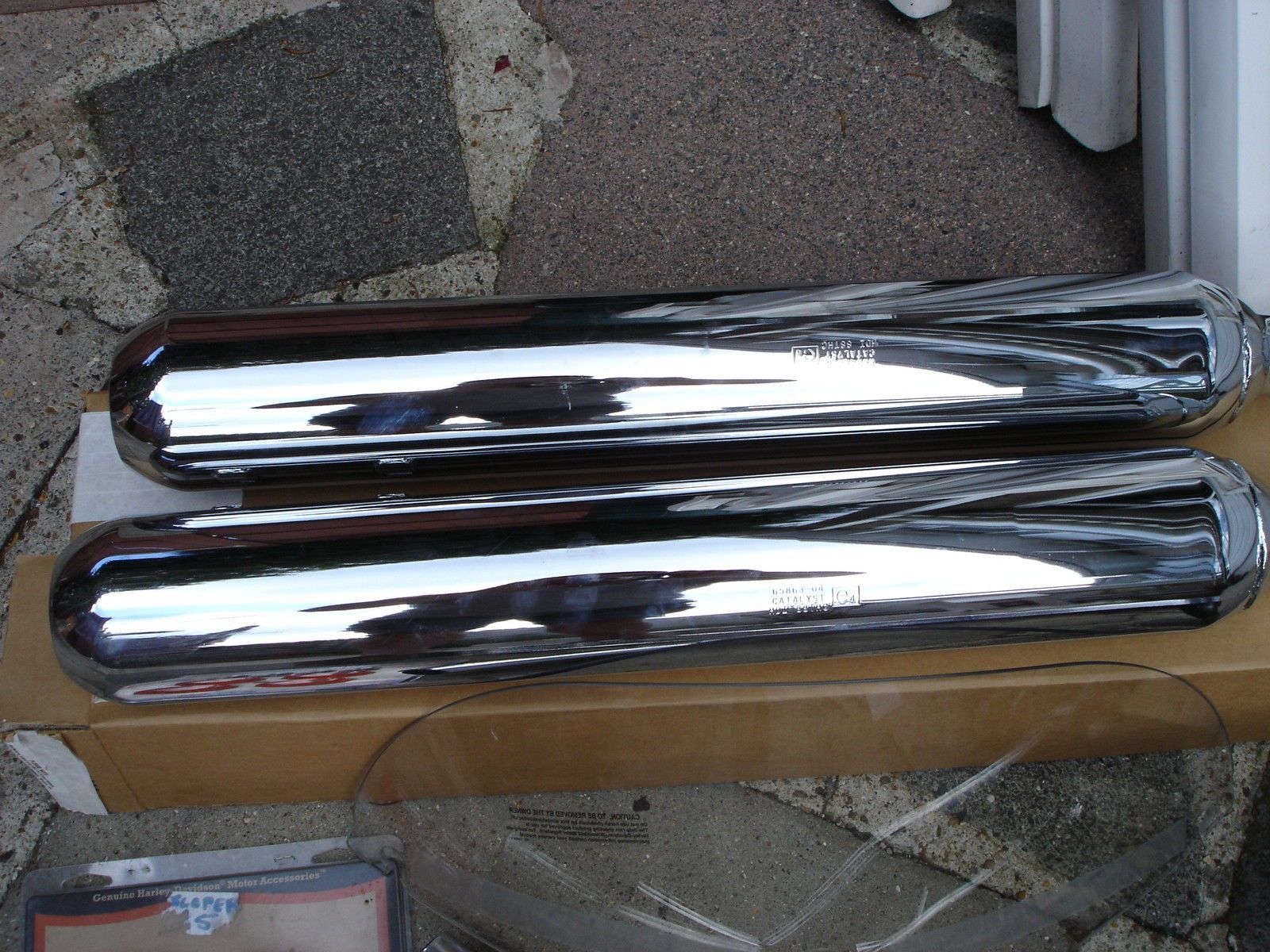

Around 2004 - 2005, H-D used catalytic mufflers (65863-04) on the touring bikes before moving on to sticking the catalytic converters into the downpipes/downpipe junction.
On these bikes, the downpipes are pretty much the same as the older models, straight thought, and it looks like the RHS muffler is just one big catalytic converter. The LHS muffler is almost blanked off with a pea sized hole and some chambering.
Yah, I know .... it's a H-D, throw another sh*tload of money at it and buy a new set of proper pipes ... but I can pick up a set for almost free, enjoy hacking things around, and just want to fill in a gap in my knowledge. The down pipes alone would be a upgrade for my old Evo. I was not paying attention to the Tourers at this time. It seems it must have been an unpopular design as it was dropped quickly, I guess because of their bulk.
I know folks de-cat the later downpipes ... did anyone try de-catting this muffler? Just boring a hole straight through the middle of the muffler? As far as I can see, there are no chambers and it's all just stuffed full of cat cells.
How restrictive where these things? They certainly look fatter than older and subsequent ones.

evo and twin cam headers interchange if you need to replace the ones on your evo.
performance advantage?...none.
2 x 1.75" pipes.
You can mod your mufflers, but anyone smart enough to look for a stamp will probably also be able to jam a nightstick up your hole.
you may do better to get 2010+ muffler which do have a stamp, and are much less restrictive as they are meant to be used with the catted header.
i run SE Fatshots on my 09. these are stamped compliant for 96,103,110 but my header has no cat...and the security screws fell out. the disk stacks are altered and i have closed end caps

Originally Posted by mkguitar
... but anyone smart enough to look for a stamp will probably also be able to jam a nightstick up your hole.
My eyes watered at that. Is that a special public service the police in San Francisco offer?
On a said muffler you could the last couple of inches of cat baffler.
I am not after a performance upgrade, just a cheap to no cost replacement. My header has rusted through at the join/bracket and looks like the surface of a rotten potato.
I'd just not seen any discussion of these particular mufflers ... may be they're are Japanese and European H-D? Basically, you can shine a light straight through them. The muffler looks like one big solid cat.

I believe those cat mufflers were required in California only back in 04-05 era. As such, you don't need them in other states. Catalytic converters generate a lot of heat. I'd be awful inclined to go with stock federal take-offs instead of seeking out a set of cat pipes. Especially if you aren't required to run a cat.

I had the '06 CVO touring mufflers that hat cats in both mufflers. I was able to cleanly bore through them by hitting a sharpened 1.5 steel pipe with a small sledge through the cat material. Once the cats were out they were a nice mellow muffler with a deeper tone then stock.
I know some people did the same using a concrete boring bit with exentsion.
