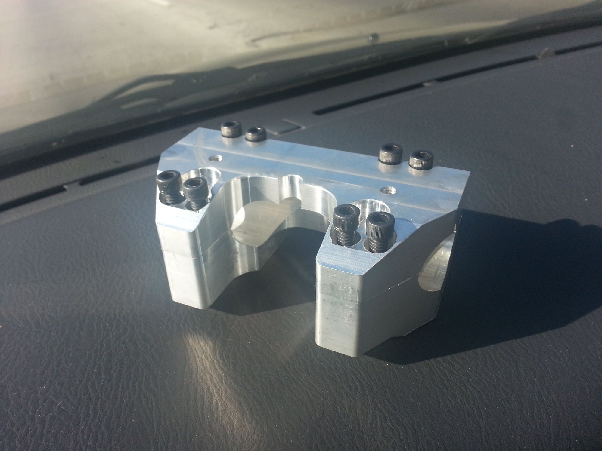

Thanks for the quick response...I did some research and found that LA Choppers makes a 1.25 riser for my application for about $110.00. The part number is LA-7420-00. I hope the clutch and throttle cable extensions he gave me fit my bike since his was a 2005 and mine is a 2001...from what I can tell, they should.

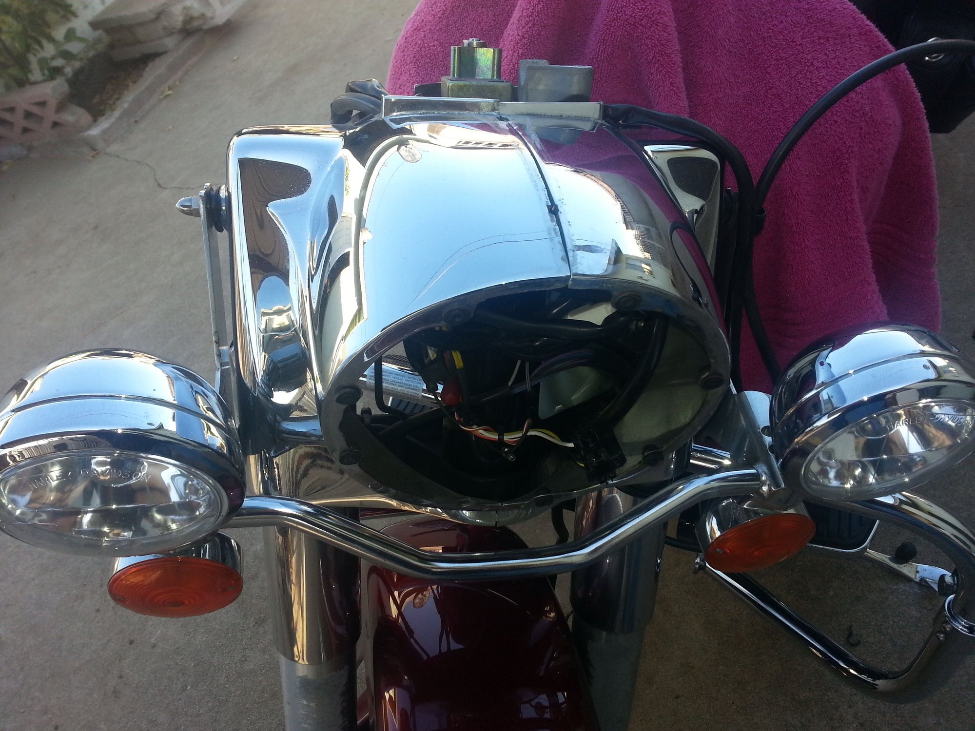

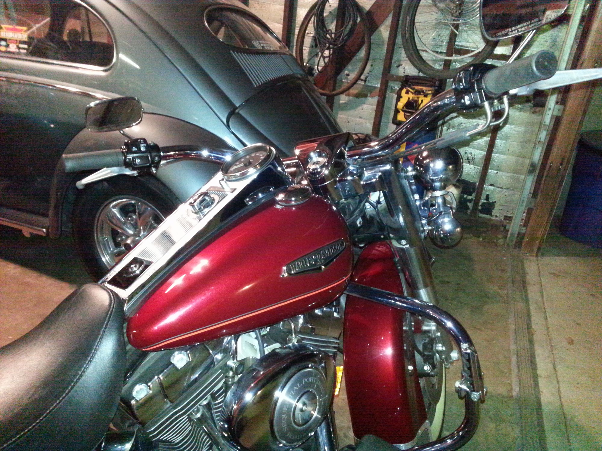

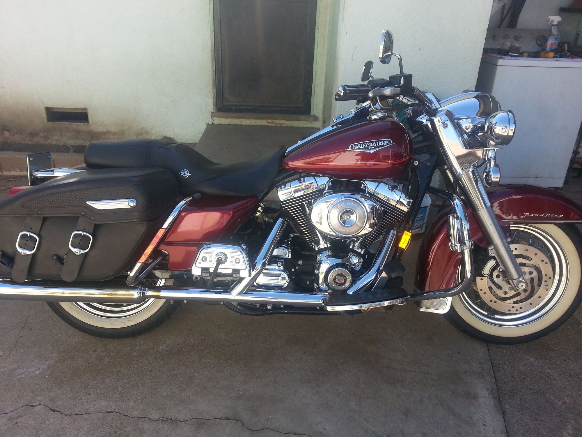

Ok...so I called around a few HD shops in my area and got quotes of $300-$1200 to swap bars and all cables. I figure if I could build a 9 second drag bug including cage, chassis, all fab work, and motor...there is no reason I can't swap a pair of bars!!! I started pulling stuff apart at around 4:00 pm yesterday and finished up the bars at 9:00 pm...now I see why they want to charge so much. I had to extend the wiring about 6" so I soldered every wire and covered with heat shrink. I still haven't done my cables yet but the factory cables were long enough and I had to straighten out the front brake line so it would work for now. Here are a few pictures of my bike. Next I will be looking for a solo seat and rail guards all the way around for that classic 60's look.

Here is a picture of the riser I had to buy for my bars to work. It's made by LA Chopper.
