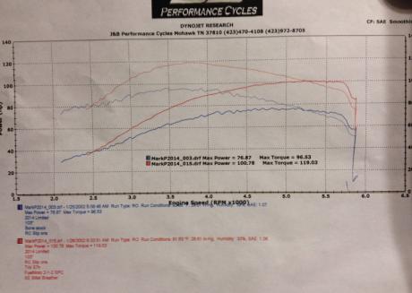

Well too me the best of all listed here is the Andrews 57's. I've seen several dyno sheets as mine as well and these cams are very hard to beat, especially for the money. Personally I wouldn't pay the $150 dollar difference for the Woods 222's. I'll post you 2 dyno sheets to look at, the 57 cams is my bike and the Woods 222's is a 2012 Limited from a friend of mine but the dyno sheet don't let you know that the 57's just plain feel better imo. Take a look and hopefully this will help. Also we did the 2015 calibration to my bike and retuned and got it too break 100ft lbs about 200 rpms sooner than what my dyno sheet says and gained 10ft lbs down low, I just don't have that print out.

I am very happy with my 57h grinds all through the rpm range. If someone complains that they dont have low end torque, then its usually because they dont have a proper tune on the 57h.

I'll agree 100% !!!
