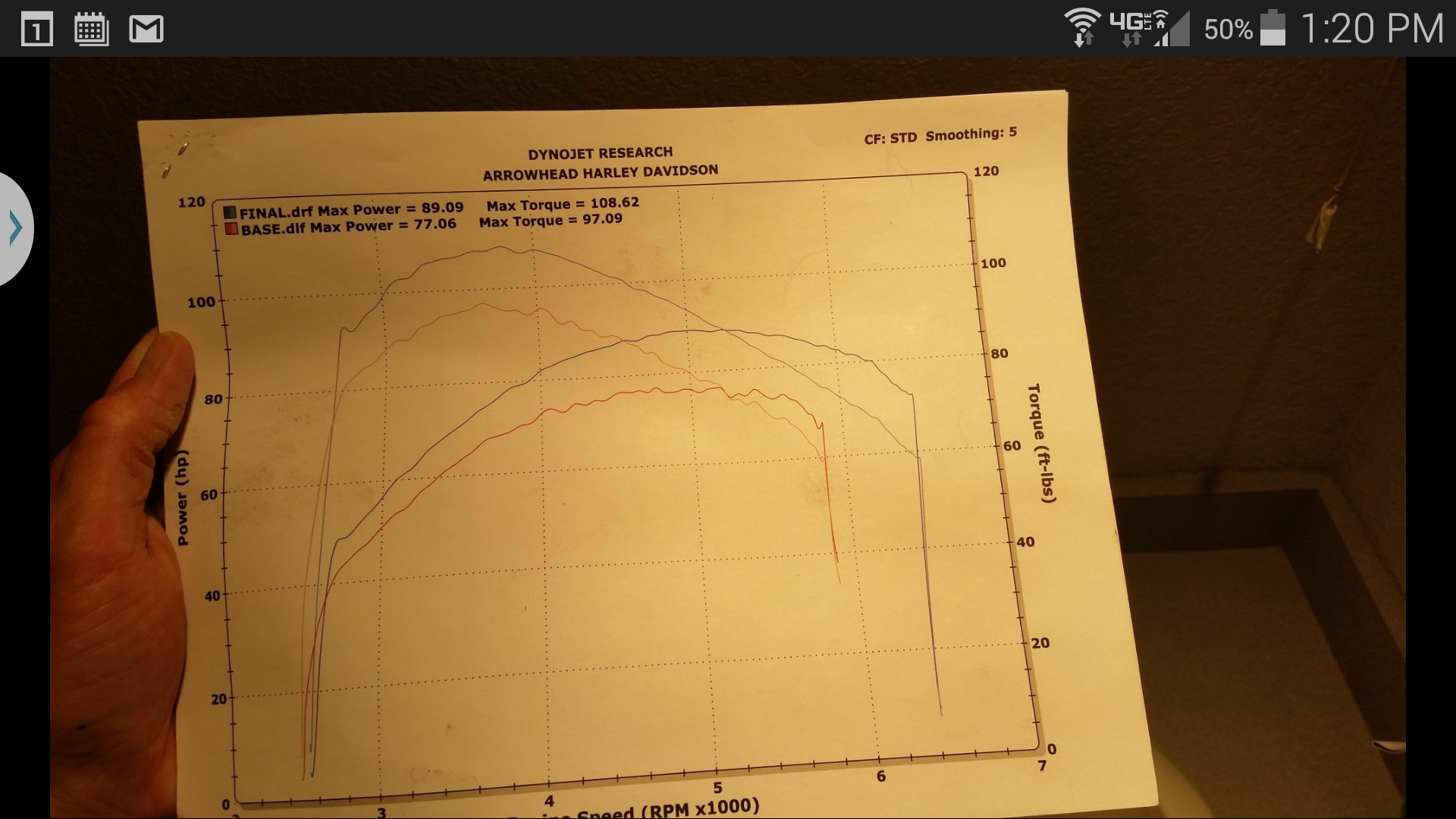

From: Sedona, AZ
Wink more food for thought
2015 Road King
Thunderheader 2 - 1
SE 254E Cam kit
SE Super Tuner
SE Heavy Breather
Before/Base
77.06 HP
97.09 TOR
After/Final
89.09 HP
108.62 TOR
