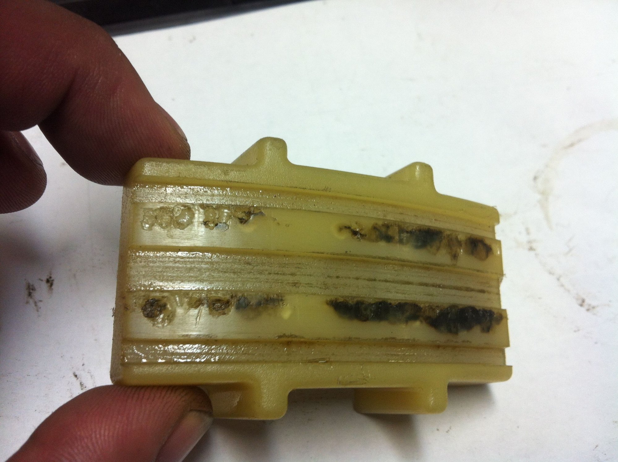

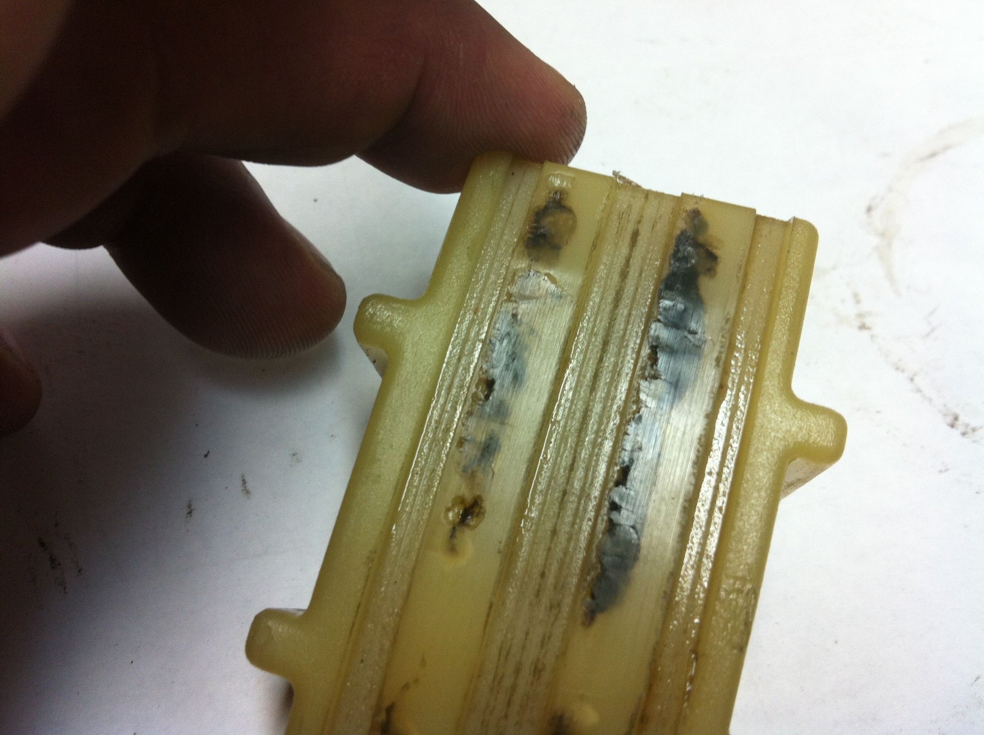

I had a Hayden M6 BT07 tensioner installed on my 2012 Ultra Limited about 2000 miles ago. There has been a whining noise getting louder and louder so I took the primary cover off today and pulled the tensioner. This is what I found.
Hayden isn't answering their phone right now so I'm waiting for a returned phone call.
Anyone seen anything like this before? only 10,000 miles on the bike, 2000 on the tensioner. There were no shims installed, just the bracket, double spring assembly and shoe.

Looks like the 3 rows of links is fully worn in and the rollers are rolling. Those missing hunks are from the load and chain speed cavitating in the oil blasting out the material. Not sure if that would whine. Did you see many chips of steel from a too tight chain? Did you pull clutch hub and peer in there and make sure inner primary bearing looks and that race on the transmission shaft it runs on lookd good? With clutch hub off, look in the back side of it and spin it and make sure that huge ball bearing that supports the hub looks and fills good. That sure is a lot of wear for 2K of miles. My manual adjustment block has never grooved in but half of that and rollers still don't roll in over 48K of miles

I hate to say it but that appears to be the typical issue with the M6 if you look around.
Most either remove a spring and try again or remove the whole thing all together in favor of something else...
The thing is simply too tight and not enough surface.

I had the M6 for ~4000 miles. Whining noise never go away, and then one day I got a loud grinding noise, took the primary off, the shoe broke into halves. Used springs as instructed and no shims, clearance is 1/4" when new.
Changed back to stock tensioner. Just check the tensioner every 5000 miles to make use it doesn't over tighten.

My stock tensioner with 30K on it looks far better than that with 2000 miles.

I just got off the phone with Hayden, They said the shoe looks like it may have been defective from the factory and are sending me a replacement shoe and springs at no charge.

I use the HB125 hyd.tenioner never had a problem. The whining everyone has complained about is due to an over tight chain.this is whats causing the shoe to wear prematurely

I installed one in my 2011 street glide. It was on for 10 minutes. No shims, chain way tight. I put the hd back on and flea bayed it.

I had the M6 on my 12 Ultra. Almost immediately it was making noise, which just got worse over the course of about 500 miles. Off it came and I reinstalled the stock tensioner. No more issues. You will find as many folks who swear they are the greatest thing ever as those who have had the same experience I had and are disappointed with it. It seems to work best on older bikes, particularly with well worn (stretched) primary chains. Mine happened to be very tight, even without the addition of any shims.

Yep, I've got one out in the garage junk drawer just like it. Put the stock self adjuster back in. (After welding it so it wouldn't self adjust.)
It's been peachy since.
