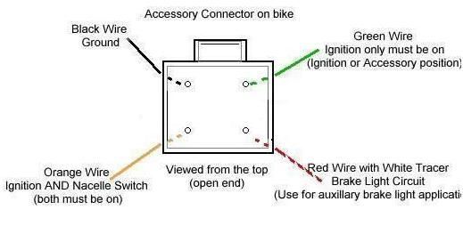

In case you are interested in the factory pins:
I wouldn't rule out some Radio Shack geek being of some help...

I have always built my own adapters for the accessory switch. One place to by the parts is Batts Racing. http://www.deutschconnector.com/prod...ay_connectors/
Old Mar 14, 2015 | 11:36 AM
bigdumbnoitall00's Avatar
bigdumbnoitall00
Joined: Dec 2007
Posts: 8,341
Likes: 714
u can get crimp on duetsch connecters for about 10 cents apiece, they look like small banana plugs.
