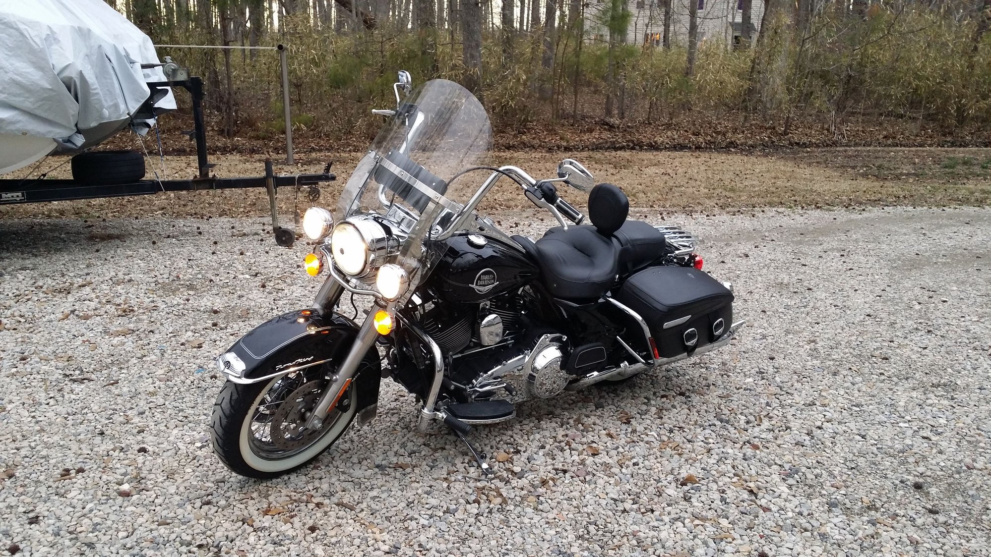

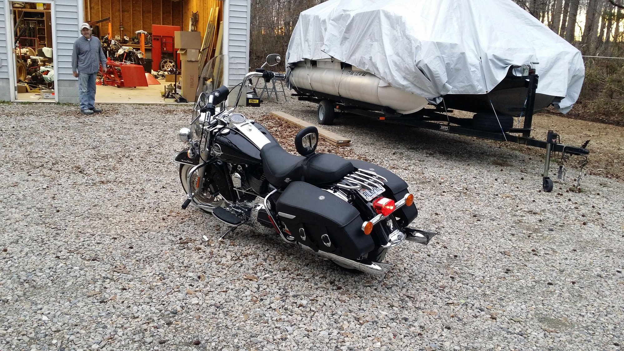

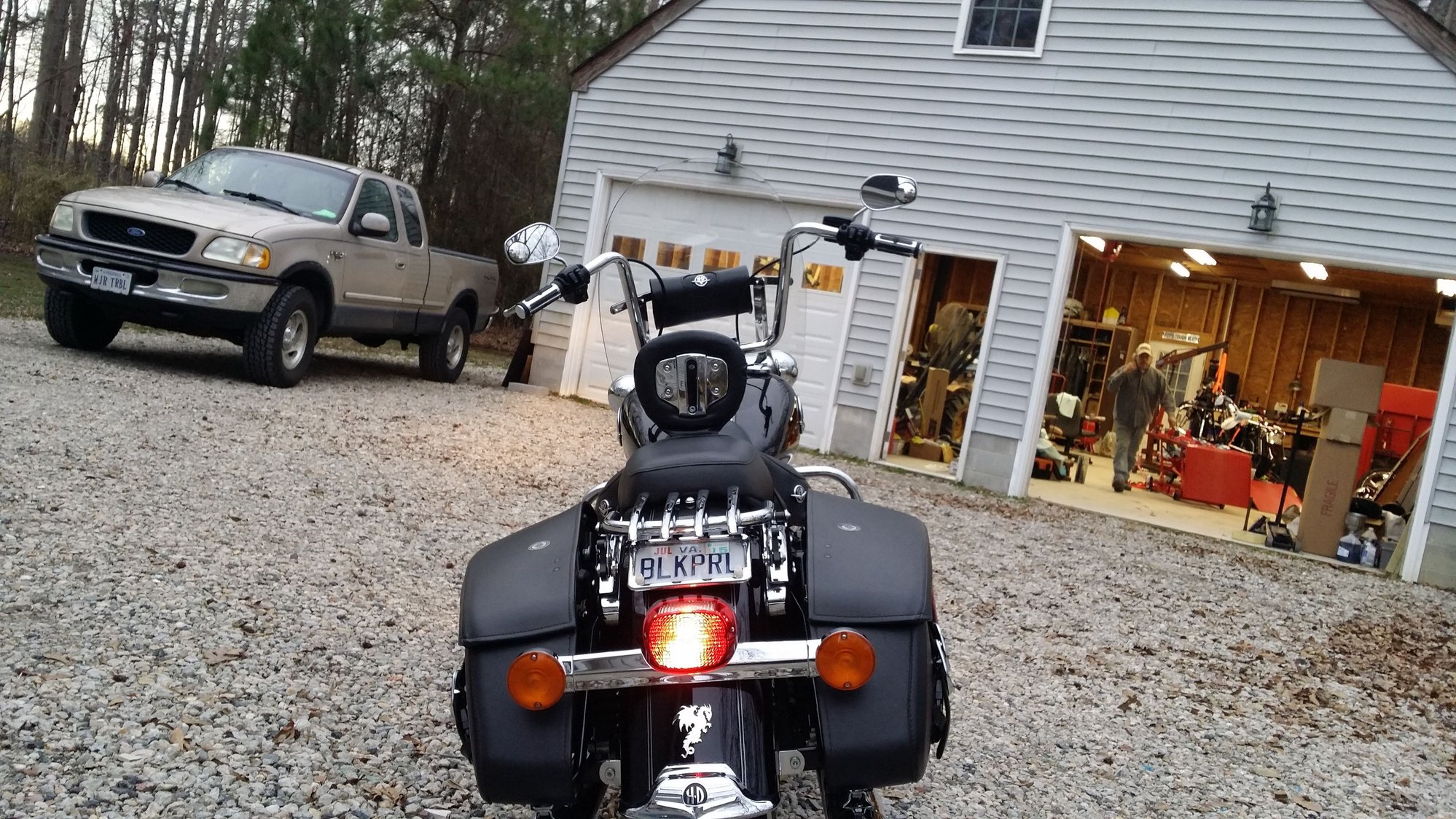

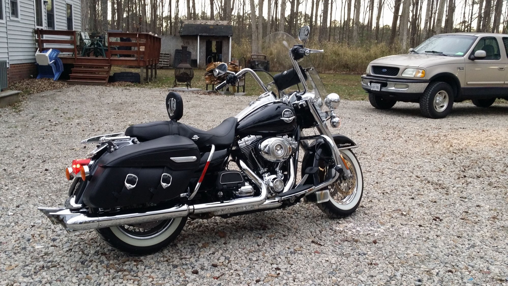

We just installed the LA Choppers Ape Hangers on my buddy's 2009 Road King yesterday. The bars are 14", 1.25" tubing. Had no issues what-so-ever getting the wires through. Much easier than mine & my dad's 2015 SGS with Vindikta 14" bars.
We did use the clutch/brake 12-14 extension kit from LA Choppers along with the wiring extension too.
I will say this, we do not care for the LA Choppers front brake extension kit for the non-ABS system. The stock front brake lines are a 1-piece unit and the LA Choppers is the split block where the lines are screwed in via flared brake line fitting. Not really terrible but we don't like the fact that the lines screw in and the flared fitting is what retains the rigidness for the lines to go down to the calipers. When the suspension moves the brake lines move a little too and would be putting the pressure on the flared fittings. Not saying it wouldn't work we just don't care for the design. We ended up tying the new brake line into the stock brake line this way it uses the stock split block and we feel it avoids the possibility of future leaks. Just a preference on that.
Good luck!!

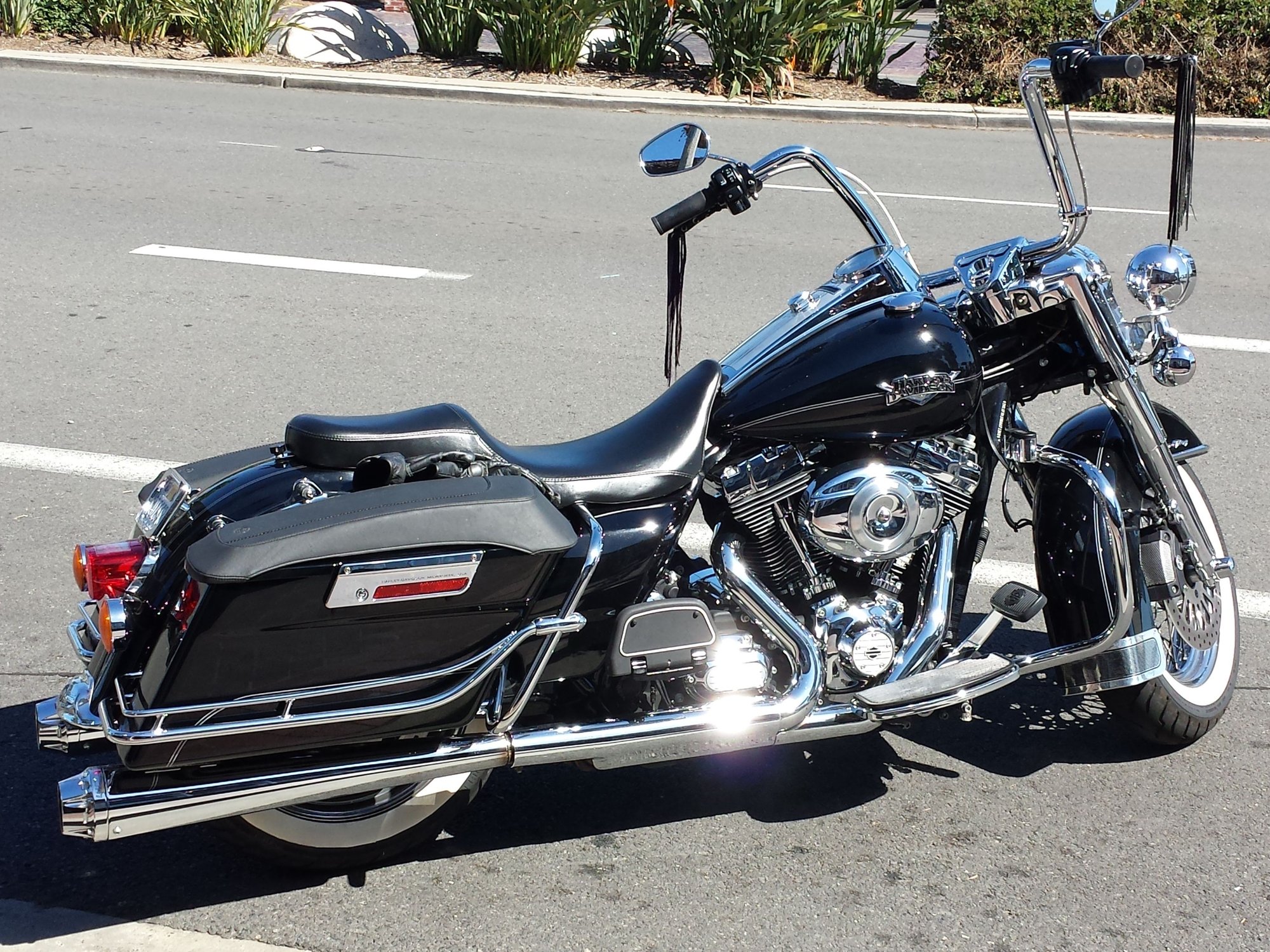

I went with 12 " Carlini's and I'm very happy with them. They actually measure out at 13.5 inches. I had to extend the wires and use longer brake line and clutch cable.
