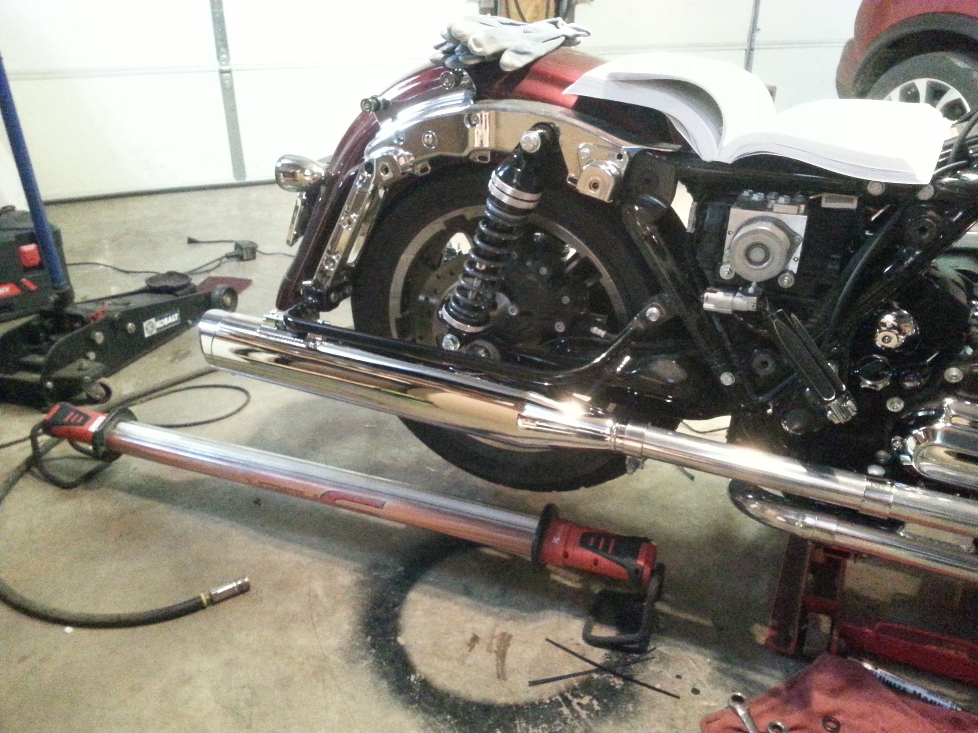

Did you have any sealing issues with them at the head pipes? Mine came in today and I cannot get the right side to seal for crap, this is just looking through it, can't start it yet as I'm waiting for my push rods to show up. I believe it is screwed up from manufacturing. If I shine my light into the muffler I can still see light through the split under the clamp. So I know darn well exhaust will come out. I had that issue one other time with the v&h ovals. I wonder if they make these for kuryakyn.

717rfulton - You say you see light through through the slit under the clamp. With the muffler installed correctly onto the head pipe you should not be able to see light through the slit. Do you have the muffler pushed far enough onto the head pipe? Compare and measure both mufflers and see if both are installed an equal length compared to the fender tip or some other part on the rear of the bike.

O yeah. Its on all the way. Header it about 1 inch past the cuts into the muffler . I've installed my share out slip ons thats for sure. lol... Seems like the ones that only have the 2 cuts instead of 4 never seem seal the best. They do look good tho header is rush high output and clamps are all new too.
