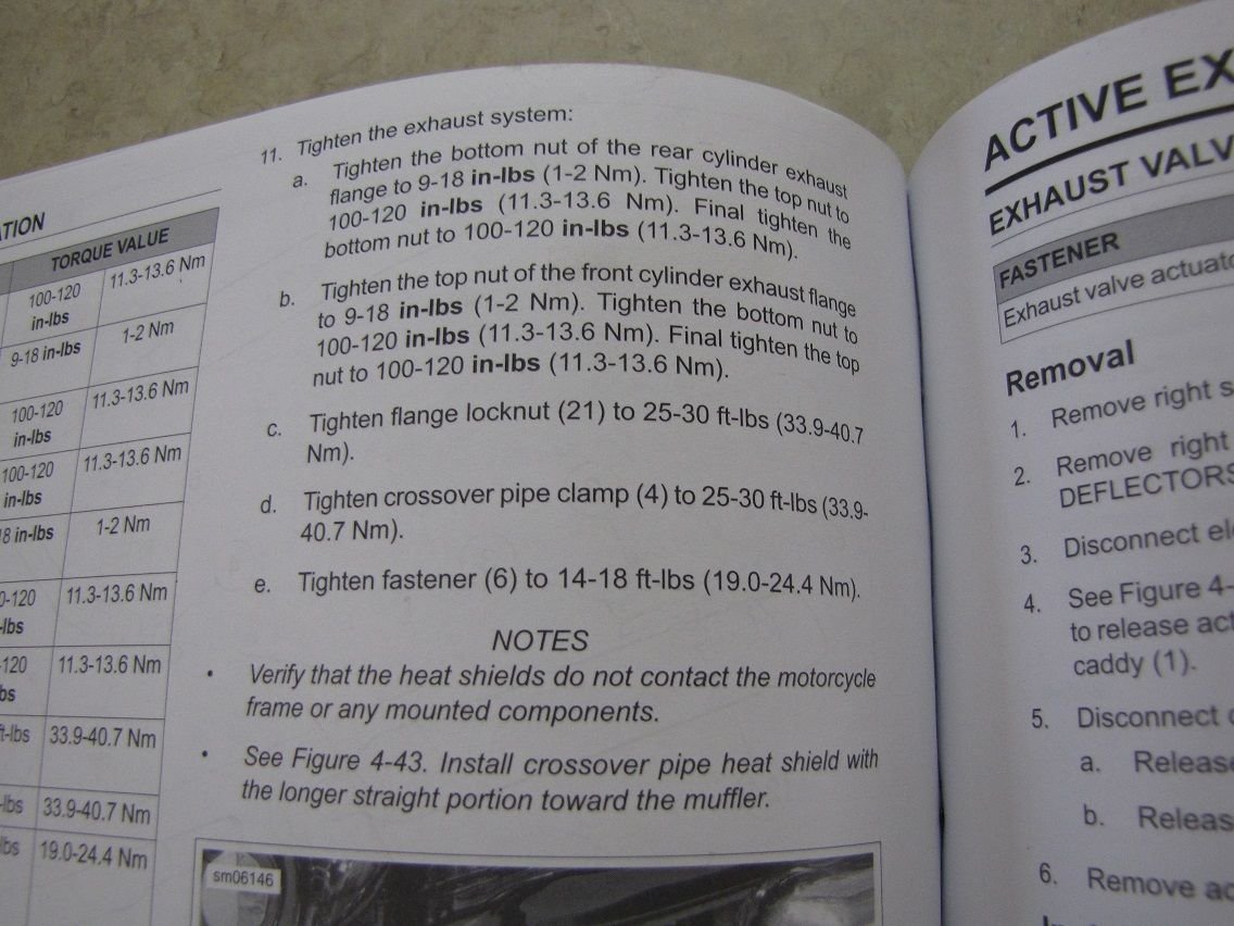

Switching my catted pipe for a non-catted pipe. Want to ensure zero leaks, the first time. So I've got the new gaskets in the freezer. (read that to be a good idea, on here.) Is there torque specs or a sequence of torque specs that may help to do this correctly.

Yes there is and also a torqu sequence
It's in the manual but from memory.........
Front cylinder upper nut 9-20 inch lbs
lower nut 100-120 inch/lbs
upper nut 100-120 inch/lbs
Rear cylinder
Lower nut 9-20
upper 100-120
lower 100-120
I think that is what it is, but check the service manual

from the 2015 manual. And do the Auto tune when you get it back together it is well worth it.

Well, hey that works guys!
Downloaded new map into P.V. gaskets in freezer and specs ready to go!!!
Shoot! Still waiting for new pipe to show up! Lol! Proper prep is all.
