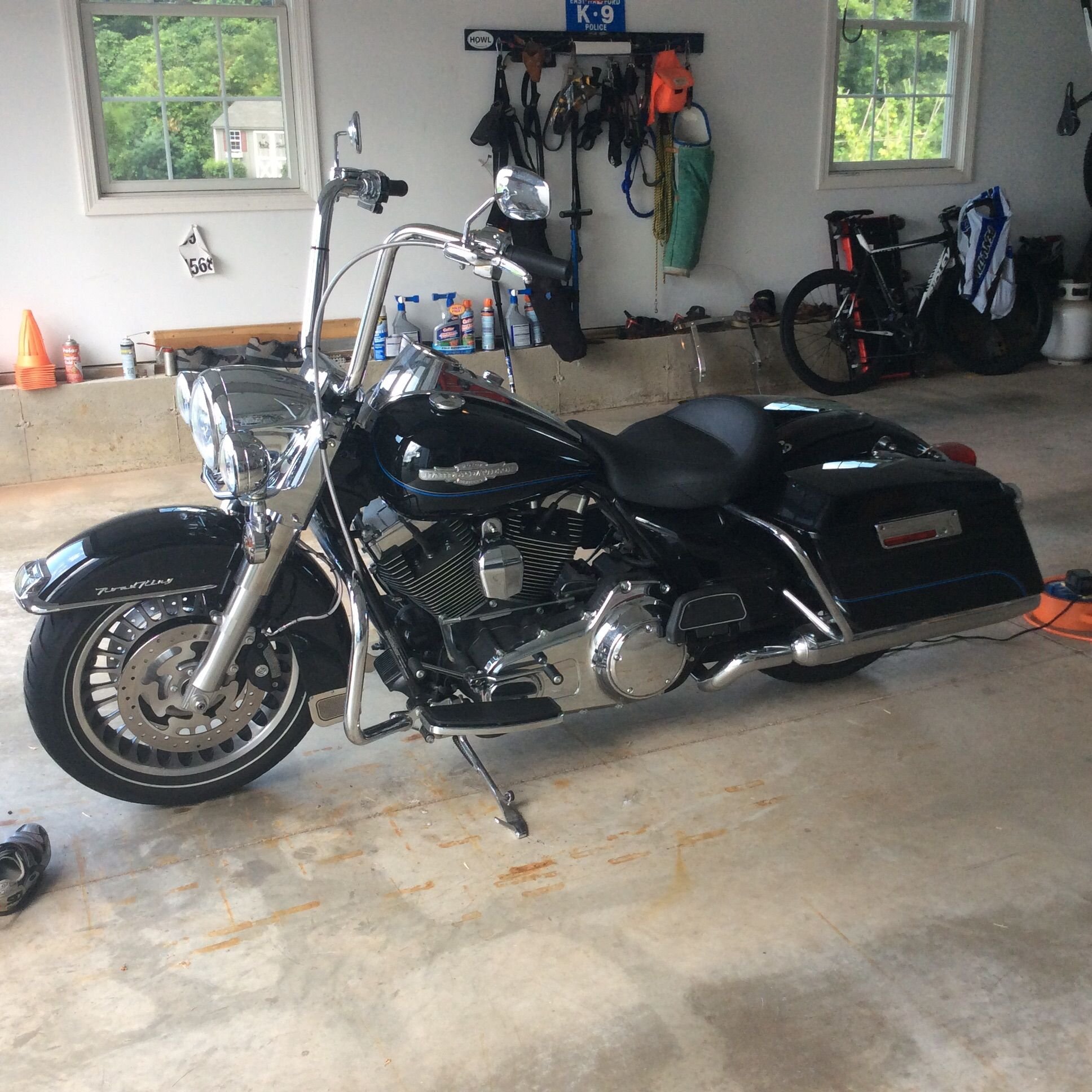

I think +8 may be a little too much for 14's. I rolled with +8 on 16 Carlini's, which is actually almost 17" and they were just about right. Your call, but here's a pick of my setup. I would shorten by a couple of inches.

Here's the link and a pic of the complete kit I bought from HD Bike Parts. (I got the socket from Advance)
