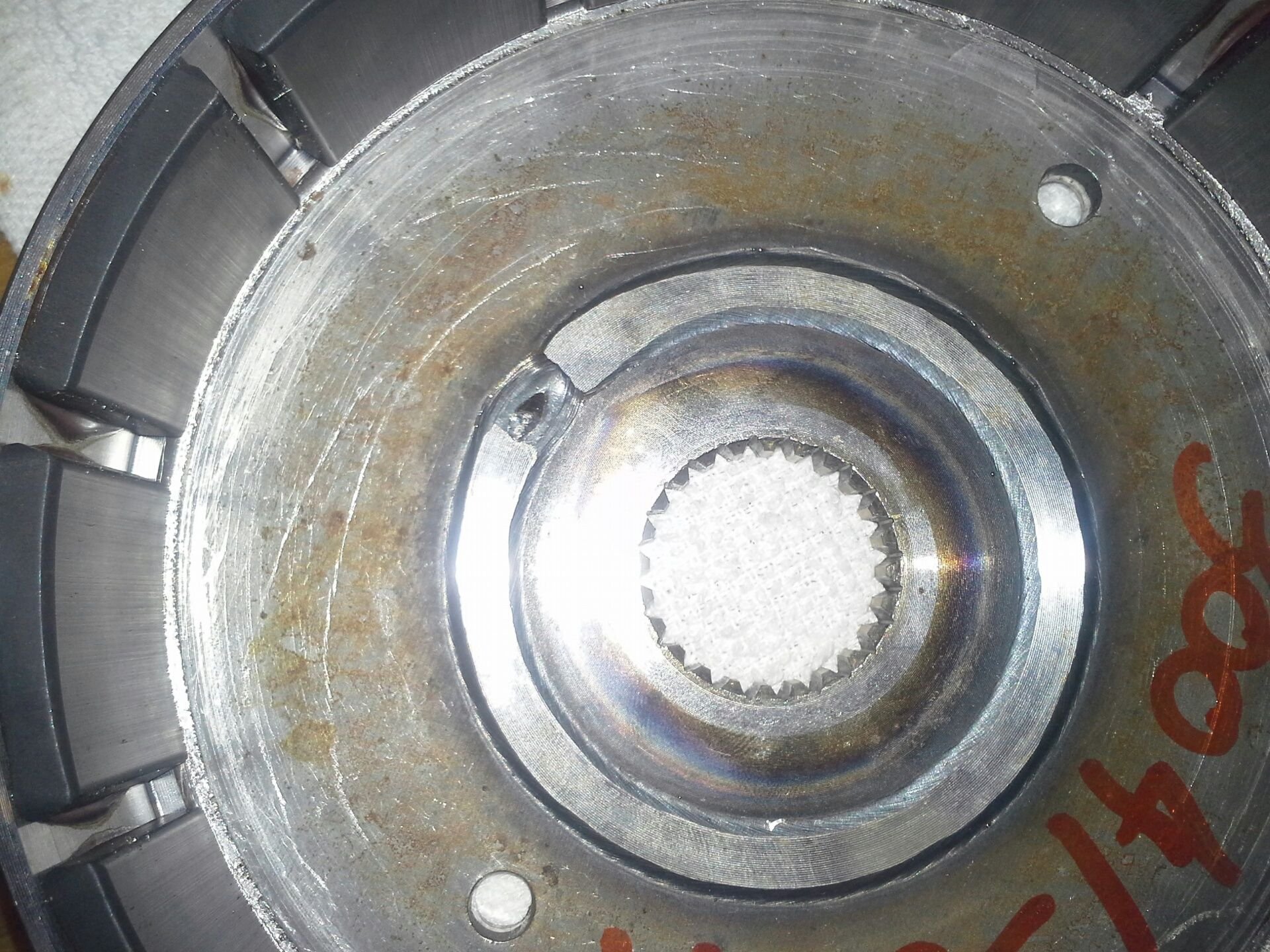

Here is the pic.

Originally Posted by classicjade01
The one they put on my bike looks like this i believe...
That is the right one, we can machine the extension shaft down for you to get it within spec but I would have your mechanic double check the alignment again per our instructions before we do so. Have him pay special attention to the second step on page 5. I have had a couple shops over look this step not seeing the importance in it being that the inner primary is attached with other bolts already. This will cause a variance with the front of the inner primary floating.
Here is a link to the instructions:
http://bakerdrivetrain.com/wp-conten...-V5.060815.pdf
I had wondered the purpose of that step... thanks for the explanation - I can see how that would eliminate the variance in the measurement. I am betting that might be the issue with the OP's installation....

Jeff has been in contact with the mechanic and I will keep everybody updated.

Sounds like the problem has been solved. I guess he rotated the crank and it fell in to place. I'll try to get more specifics.
